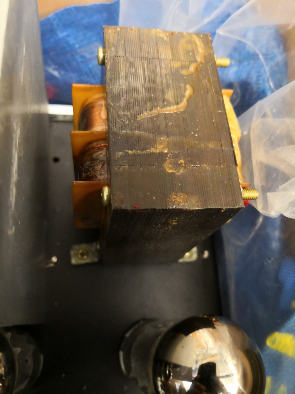

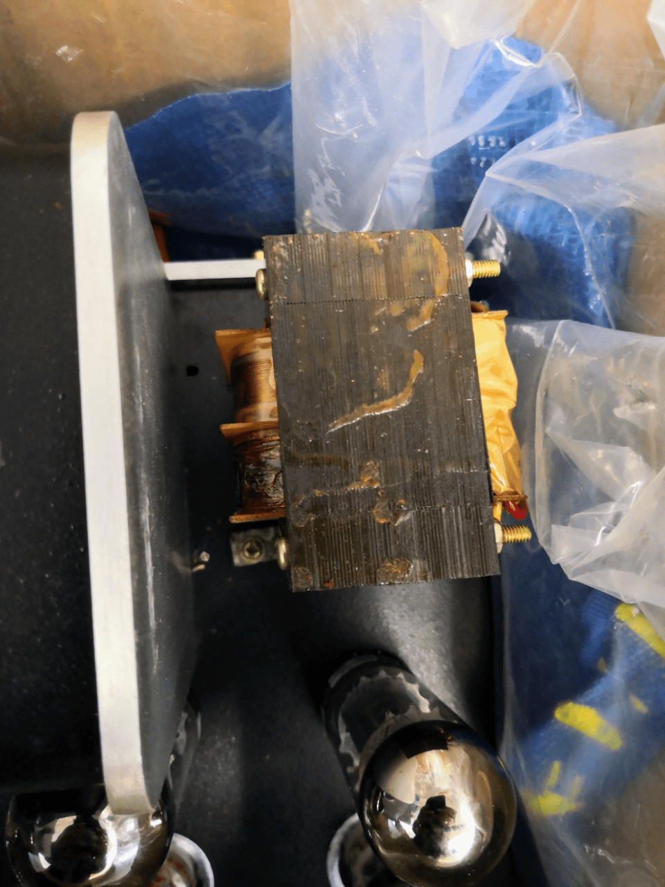

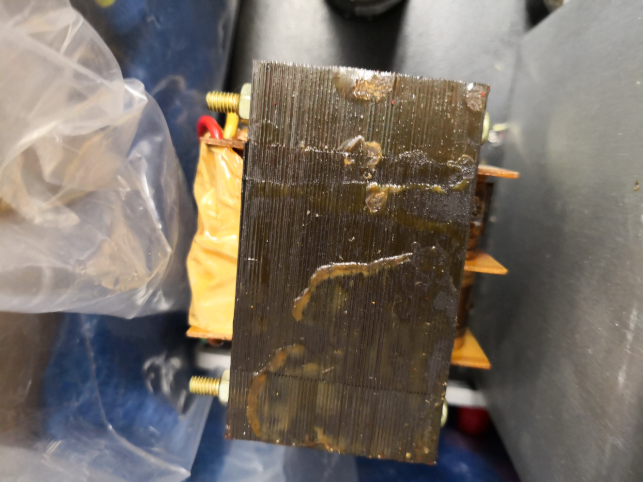

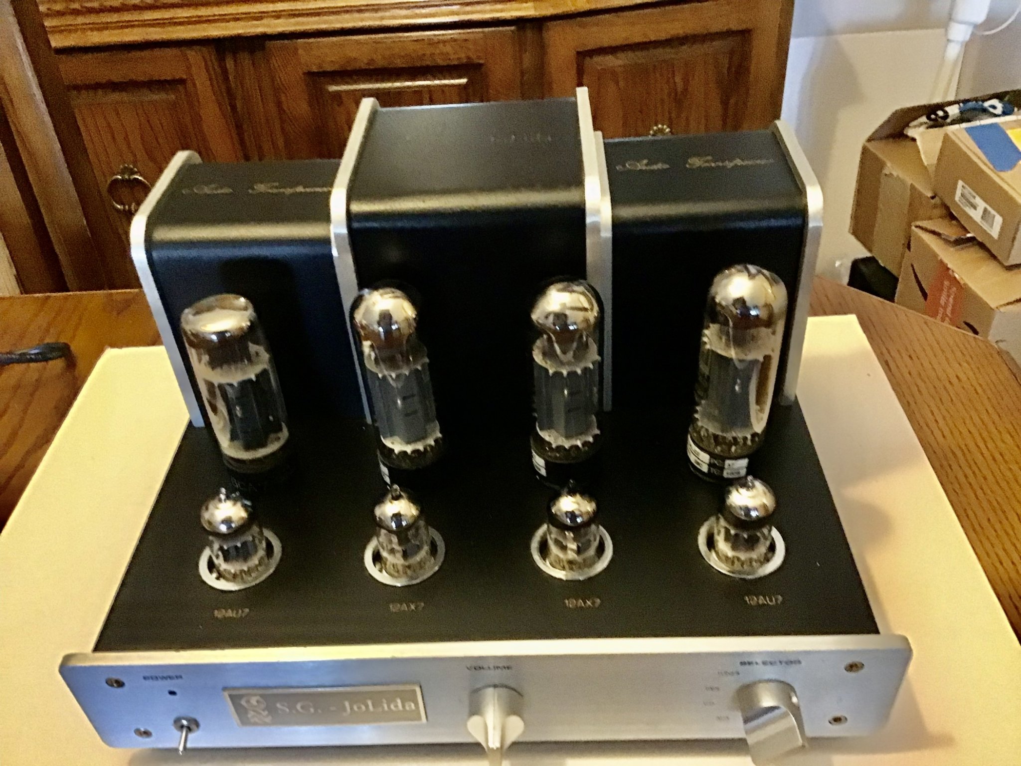

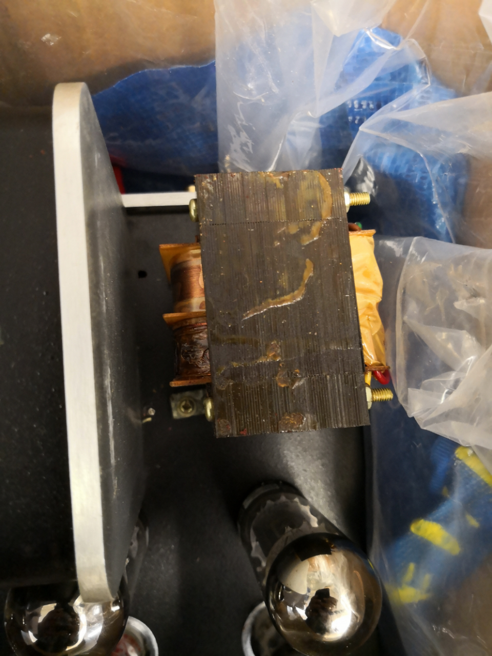

Hi guys, I managed to blow my right output transformer on my Jolida SJ/202a int amp.
it is a 40wpc, EL34 tube amp.
Does anyone know of a correct substitute for this amp?
I called Mike Allen of Jolida, but no stock available.
My technician is finding a challenge in sourcing one of the correct size.
The dimensions are 3 3/4”t x 2 9/16”w x 2 11/16 d

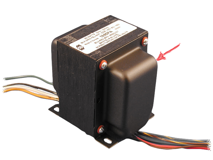

A 30W Hammond 1645 might fit with the end bells removed, but there's no way to know for sure unless you have one. http://www.hammondmfg.com/1608.htm
A 30W Edcor is definitely not going to fit.
jeff
Thanks Jeff. What are the end bells?A 30W Hammond 1645 might fit with the end bells removed, but there's no way to know for sure unless you have one. http://www.hammondmfg.com/1608.htm
jeff
