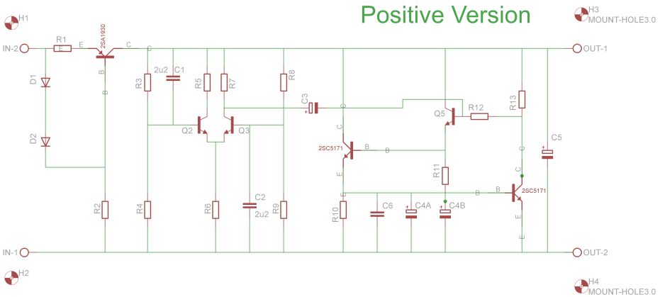

" R3 is optional. Fit for added performance only if Q1 and Q2 are matched. You can match hFE on your digital multimeter - do it, fit R3, know you've done a good job!"
I would recommend fitting this resistor irrespective. Most transistors from the same batch are often reasonably close in HFE and VBE.

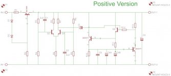

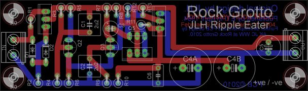

Updated everything!!
Hi Everyone,
Here is the updated BOM and schematic - and a picture of the whole board.
I have updated GT6 . You will find larger versions of the schema and board here. EDIT: Having a bit of trouble with the images. Seem to be fine in FTP, but not linking correctly. The images here are the best bet for now. Sorry!
Please feel free to cross-check the BOM, schema and board. I have already done so, and a friend is hopefully going to cast his eyes over it as well. Please let me know of any errors you may find (I think there are none!!), before I place the order for these boards next week.

Hello Jon,
Can we make the PCB smaller by removing the wordings on the PCB top right hand corner? Then insert the wordings some where else like in between the tracks or so?
Of course fff0 is correct. But there is something kick a## about a pcb with Rock Grotto Ripple Eater on it.
I don't think it's worth your while to change it at this point. Only if there's an error somewhere.Hello Jon,
Hello Jon,
Hi there,
Sorry, board design is now frozen. This design has been test-etched and has been electrically proven. To give some background, not only are we using the copper layer to place provenance information, but the large 4700uF caps (C4a, C4b) may be mounted lying down to reduce stacking height. If you opt for this method, then the FR4 real-estate in that location is required.
Method in the madness! 😀
Cheers
Jon
BTW, I'm more than happy to share the EAGLE .sch file with you if you'd like to experiment with alternative layouts.
Hi there,
Sorry, board design is now frozen. ........ but the large 4700uF caps (C4a, C4b) may be mounted lying down to reduce stacking height. If you opt for this method, then the FR4 real-estate in that location is required.
..........No problem mate.
Its a good idea given by you for lowering the stacking height.
