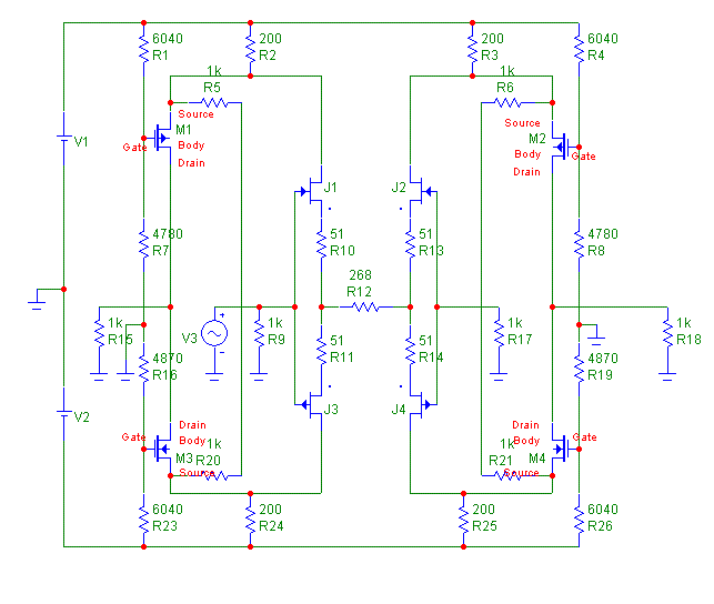

Modified JC 80
… Just a global attempt to update the JC80 for fun, with today’s components.
Resistors values are changed to fit the Irf devices requirements and to reach a 20kHz bandwith in open loop.
The 2SK389 and 2SJ109 can be replaced by the 2SK170/2SJ74 of course, but also by other ones as suggested by JC, in this case R2/R3/R14/R15 must be adjusted. In my case the SK 389/SJ109 Idss value is 10 mA. Mosfets Idle Id is 50 mA. I changed the original input stage arrangement for this preferred one. It just a starting point, probably the MASTER will see some possible improvements. I didn’t build it, some measurements with real devices could lead to various modifications .
Gain 12dB.
Zout 50R per side.
The DC servo could be something like the one I post about the Blowtorch in this post
Richard, another "modification":
