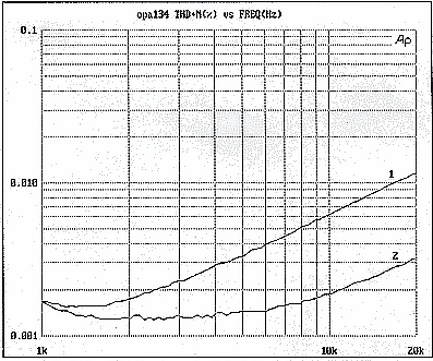

Also. It allows zero CM distortion from the amp input, but still independent setting of the termination impedance Rt and the feedback gain resistors. Have your cake and eat it, too 😉
Not my circuit, unfortunately.
Curve 1 is 'classic' circuit with inverting amp and the input to +terminal and ground.
Curve 2 is the new one.

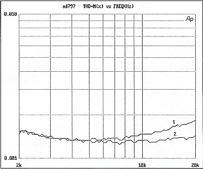

Actually, with Scotts' AD797 the difference is much smaller, ands only above 10k or so. Why is it that we always end up with his sandbox 😉 ??

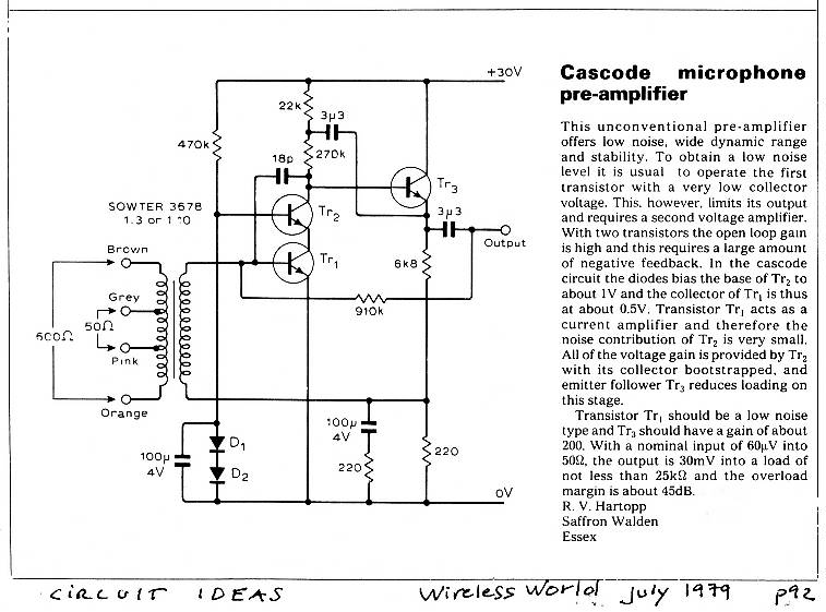

Some monthes later, a mike preamp with the same NFB connection was published as a circuit idea in the same magazine:

Yes it looks conceptually the same! The circuit I posted is described by Kovinic, Drincic and Jankovic from Belgrade and Sussex, in AES paper 7760.

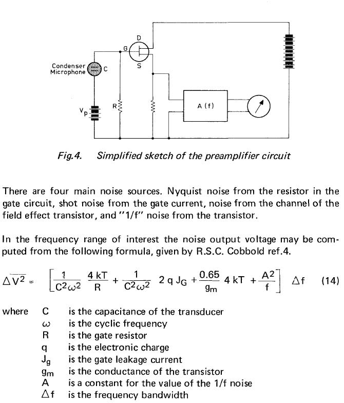

Yes that's true, that's the major low frequency noise component, it goes down as sqrt of R but rises at the low end at 20dB/decade so in general it overtakes 1/f noise. Simple RC stuff easy to compute, it gets tough when the capsule is only 5-10pF that's why MEMS mics use MOSFET's and diode reverse resistance for bias.
Does it mean Scott, that MOSFET has lower gate leakage current than JFET? But what about transconductance and 1/f noise in MOSFET? Thanks.
ok, I found reference: A. C. Pluygers A novel microphone preamplifier for use in hearing aids Analog Integrated Circuits and Signal Processing Volume 3, Number 2 / March, 1993
another reference: USPat 7110560
