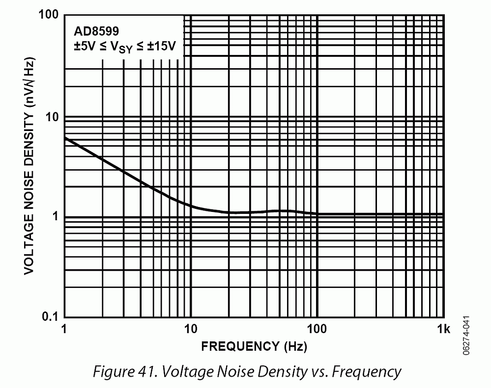

syn08 said:
OPA211 and OPA827. New generation opamps, OPA827 is JFET input and has under 4nV/rtHz noise. Ideal for a MM preamp, in particular if you parallel them. OPA211 is 1nV/rtHz and precision.
ADA4898 seems to be amazing as well, I hope to get some samples to evaluate.
Sigurd Ruschkow said:
The ADA4898 is interesting but do not forget the AD8597/99 which has low en and is reported to sound good, too.
Its design and name AD8597 are similar to the AD797.
Scott - any comments?
Sigurd
That business is all handled in CA now I'm doing 10G comms stuff these days. You might notice some of the 1nV parts have total supply currents just over 4mA, the processes are so fast that the rest of the circuit can be starved to death, JC must hate it.🙂
