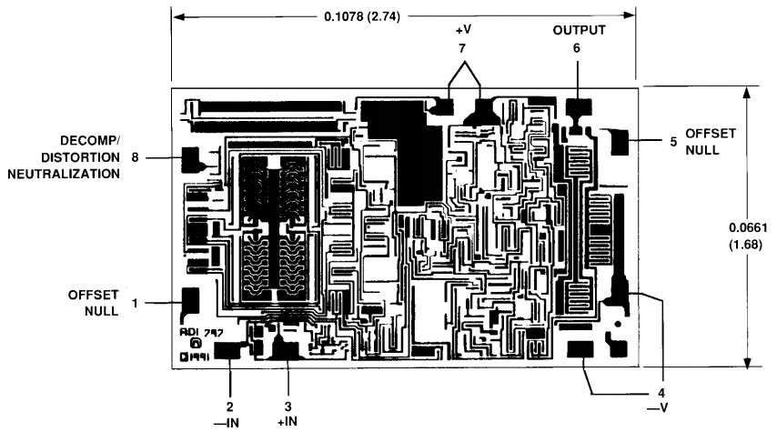

I guess the sales department made objections as an extra pin is way too expensive. 😉
Also separate supply pins for the front end and OPS would make that chip more versatile (think of an Alexander amp, for example).
Notice that the chip itself seems to have separate connections though (see pic)
Edmond.
PS: How about the MOSFETs?

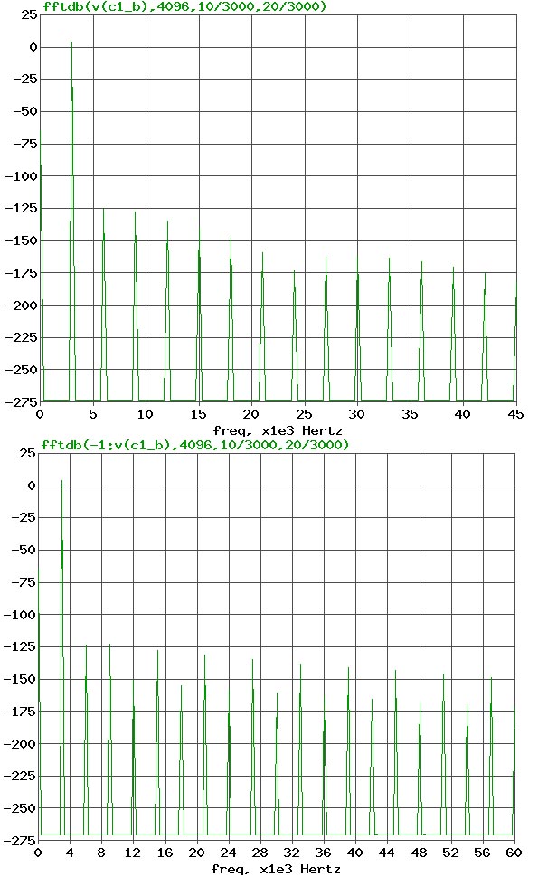

Here's my results John with (on top) a 10ma current source out of the output and below normal. Not much 7th in either case. 30dB gain with 300 Ohm feedback. Our simulator allows you to lockstep time and amplitude which is about 300dB dynamic range for the FFT probably enough. The class A current just keeps making it better there was no null point, except on the 15th harmonic for some reason. At -180dB the results are just numbers.
Another thing to think about, all op-amps have current limit sense resistors made out of very nasty diffusions (usually), high TC non-linear. They're right there in series with the output.
