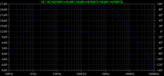

OK, here is a loop gain plot with a VCVS of value 0.9999. Unfortunately, I can't plot a family of curves with the VCVS scale factor as a parameter, because the loop gain calculation itself uses .STEP and the calculation becomes borked when trying to use it in conjunction with other .STEP commands. I've duplicated the bias conditions of using the EF, with the emitters of the current mirror at -2.2 Volts DC.
Anyway, you can see the loop gain is higher, though not exceedingly so. The loop gain is way more broadband now. The interesting thing is that the unity loop gain frequency has gone from about 1.5 MHz to about 45.5 MHz. It's still stable though.
Edit: I can't get this to look like the EF case regardless of VCVS scale factor. This may be because of the output impedance of the EF, which has about 90 uA Ic.

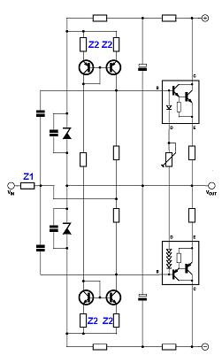

Looks like LTP, Schmidt trigger (does not latch due to working points(?), but has a huge output resistance and a voltage gain), Diamond buffer. Negative feedback through C7. C1 forms an integrator with very high output resistance of the Schmidt trigger. It adds stability on highs, but shifts phase of the feedback signal.
Can the amp work at all without a feedback on DC, or sticks to the rail?
Also, a "Diamond Buffer" can't be cured by an external bias to any rail, so I suppose the real thing has a different output stage.

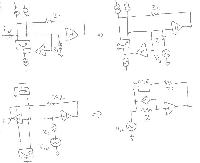

Excellent picture Brian, I see the argument. Drawing A like an amplifier might cause a little confusion. To proceed just think of taking a super diamond stage with infinite current gain and a nonlinear voltage transfer dependent on load and connecting a resistor from input to output. This creates a nonlinear input resistance/current directly related to that nonlinearity. Is this due to feedback or something more like bootstrapping? I might look at your drawing and see a half bridge that nulls the voltage error of the output stage.
So there is a semantic element to this. I didn't double check but I assume your drawing yields that the ouput voltage is gm*Rl independent of A (certainly for .8 < A < 1). That was the point.
As I said I did run this circuit with both current mirror pins brought out. It was a long time ago but I remember with an input gm of 1/100 Ohms or so and 10K resistors instead of compensation caps (just like Dimitri's drawing) I could run the circuit at an open-loop gain of 100. The output stage nonlinearity was nulled even at Rl =100 Ohms. I found the empty box in my stuff last night so the parts are gone. :bawling:

scott wurcer said:
It was useful in the past to look at the transfer function of the complete amplifier w/wo Cn (my original drawing). To me "Miller" implies gain, at G~=1 it would seem moot.
Scott, I'm talking about transimpedance here. The feedback factor of the minor loop in this case being the transadmittance sCn and the open-loop gain of the minor loop being roughly the transimpedance from pin 8 to the output.
Considered in this way, this is nothing more than a Miller loop enclosing the output stage - similar to, but not identical to, the low-distortion topology of the Smith, Koen and Witulski 1994 article.
