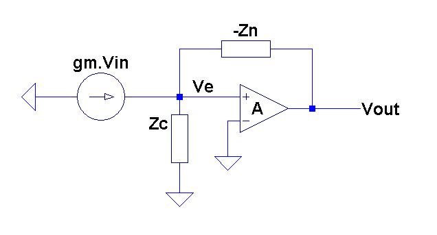

scott wurcer said:Jeez, I flipped the sense. The currents all add up the same way though. I hope this does not confuse anyone.
Yes, the currents add up for the same result. Thanks Dimitri.
Dimitri's diagram makes more sense to me. If I simplify the AD797 further I get this:
My question to you, Scott, is what choice of Zn, Zc and A make this a FB circuit, if any, and which do not. That is the crux of my challenge to your earlier rejection of the FB label.
Brian
Brian
Not shown in the diagrams. This is the matter at hand - the means by which the output buffer feeds a correcting signal back to the current mirror.scott wurcer said:Traderbam,
<snip>
I hope it’s clear that the output buffer supplies the current that is mirrored so that the input stage still needs exactly the same +-5uA to make 10V at the output i.e. the voltage transfer function of the output stage has no net error back at the input gm so that the global feedback does not see it. Please forgive that I rounded 1 1/9 to 1.1.
A little righteousness crept in there.Yes, if you want to consider a current mirror as a feedback circuit then you could argue such. These arguments like, “an emitter follower is feedback”, don’t send circuit design, as an art, forward.
I feel an urge to ask you how you distinguish between feedback and "subtractive neutralization" in a mathematical sense. I find textual descriptions are generally hard to interpret without ambiguity. 🙂
Brian

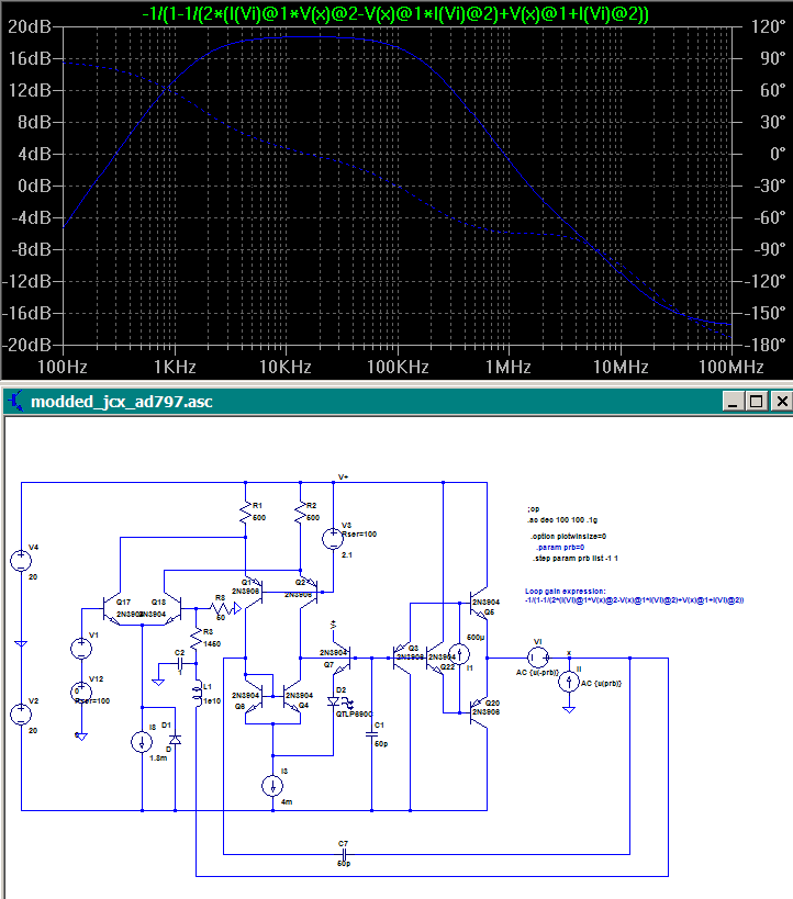

HI Brian,
I've taken jcx's approximate AD797 simulation and made a few modifications to it. I blocked all the global feedback by putting a 1e10 Henry inductor in series with the feedback resistor from output to inverting input, and a 1 Farad cap to ground on the non-output side of the inductor. Then I put a loop gain probe inside the "neutralization loop". Here's the schematic and loop gain plot.
