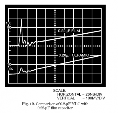

Hi Pavel,
What are you measuring there? What does your test setup look like?
Multiple layer capacitors are obviously going to have lower inductance. In use, you may need to damp them as well.
Besides, I didn't comment on what were the best parts, just what is usable.
-Chris
-Chris
PMA said:Really?
I could be as laconic as yourself and use the BS flag, but I'm in a good mood today.
That's an unfair comparison, between foil caps and multilayer ceramic, showing nothing more than the obvious. 0.2uF MLC caps are ideal for decoupling, as they have fundamentally low ESL.
The discussion was about compensation caps and DA. While JC says NPO ceramic is bad and silver mica is good, other say that a) mica has more DA than NPO, b) there's no measurable DA difference between NPO and mica at the typical values around 100pF and c) polystyrene is not commonly available under 100pF.
BTW, I doubt the cap in the graph you posted is NPO. A 0.2uF NPO costs an arm and a leg, and I doubt any sane engineer would use such for decoupling.
In fact, you just proved that ceramics are beter for decoupling than whatever foil, another BS that JC was perpetrating around some time ago. Yes, those ceramics (not NPO) may have measurable DA, it doesn't matter, at least if the amp has what is commonly known as a decent PSRR. Add -40-60dB to the worst ceramic cap and you still got a decent decoupling.
