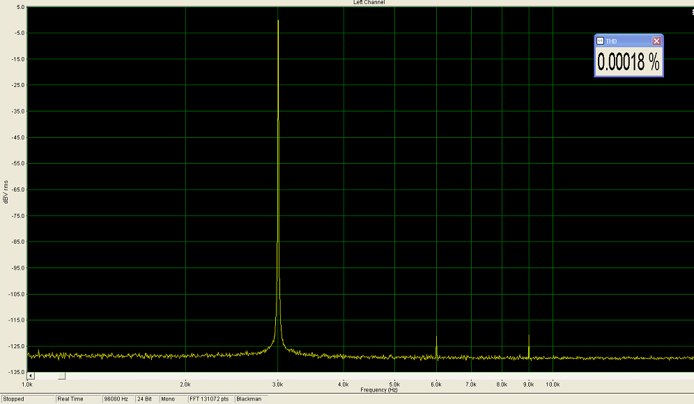

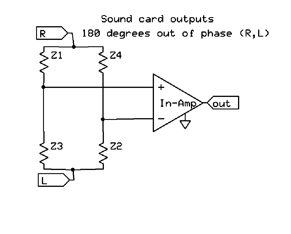

If anyone want's to try and repeat some of the old Jung/Curl capacitor/resistor quality tests, I tried a little experiment last night.
Taking the Left and Right channels on a good sound card and generating a 1K sine wave with one channel inverted made a great differential bridge drive (see picture). There was a good bit of cancellation (at least with my card) and there were no evens above the noise floor. As one can see this configuration can almost eliminate (with trimming) common mode signal on the in-amp. With care it's scary how much resolution you can get, I guarantee it will tax your ability to ground and shield properly.
My sound card showed -106dB of third at 20V p-p differential out, the bridge easily extends that another 40dB (which is only a 1% match).
