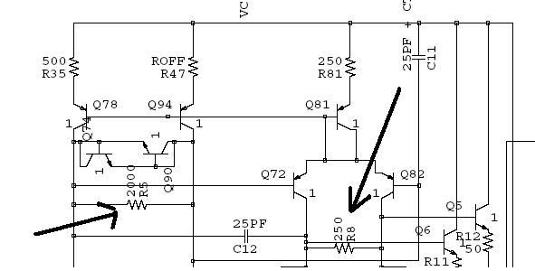

See pic, the 250 Ohms also does wonders when the rail is hit. Still optimizing on a back burner. I mis-spoke one of the comp caps can be 20pF and the other 25pF with no noticable effect (seconds go from -inf to -120dB in the case of perfect matching trannies), that's more like 20%.
G.Kleinschmidt said:
Is that 250 ohms of emitter (source) degeneration or 250 ohms collector (drain) load?
Glen
Re: Re: Re: Re: Re: Re: Re: Re: Re: VAS fighting
Q7 and Q9 are the needed?

Re: Re: Re: Re: Re: Re: Re: Re: Re: Re: VAS fighting
Possibly not anymore, they are free in IC land 🙂 Clamps are like caulk, you never have enough.
