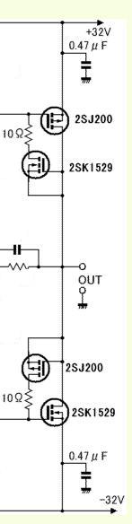

In the first, two of the MOSFETs are always off and the only effect is to add some capacitance to the other MOSFET Crss. The other one seem to level shift with one threshold voltage and add a series capacitance to the equivalent Ciss. They may lead an equal equivalent Crss (or Ciss) for the N and P channel devices (I didn't do a throughout analysis), but to me the price payed (two extra power devices doing essentially nothing signal wise) is way to high. Plus the increased equivalent Crss or Ciss, which is anything but good for the performance.
Just curious, are these snippets from a commercial product? Honestly, the idea seems to be pretty dumb. But then, what do I know 🙂
dimitri said:
What about this:
dimitri said:Or this:
