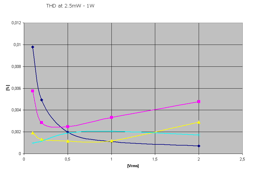

syn08, I have worked quite hard recently on collecting results of 4 very good amplifiers at low levels, they cover quite typical room listening levels. Do you think these amps would sound same?
Depends on the test.
DB, controlled test? No.
Sighted, informal test? But of course. That's what you do for a living 😉
Jan Didden
Other way around.
I dunno, it must be nice to have one of those superhuman brains that is immune to conscious and unconscious biases, that doesn't need controls, that can't be fooled. They must not have fun at a magic show. Too bad, I love Penn and Teller.

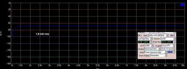

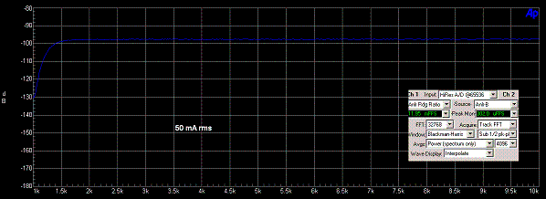

Dimitri,
Interesting!
What is the distortion level without the relay?
What is the contact voltage level wrt the relay coil and armature?
Is there any hum or AC component on the coil voltage?
Jan Didden
Interesting!
Jan Didden
Jan,
NC - normally closed pair, 20mOhm, 50 mA - 1mV voltage drop across contacts, first graph - THD+N ref 1mV, second - ref 31.6uV

dimitri said:Jan,
And 15uV thermoelectric potential.
dimitri said:Jan,
Thanks, you had me worried there for a moment 😉
I can live with -100dB re: 1mV.
Jan Didden
