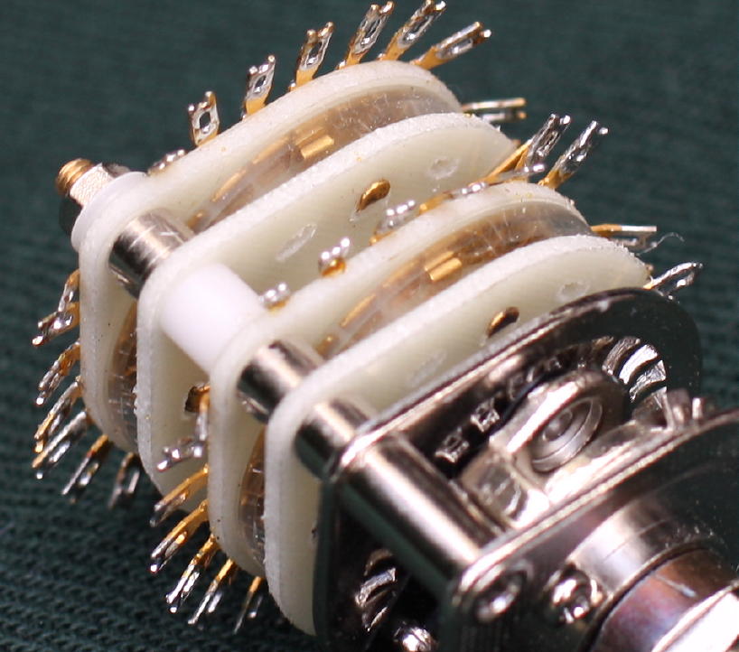

Peter Daniel said:Hi Bob,
I believe this is what Charles is talking about:
Hi Peter,
Thanks for the pics, presumably of a more modern Shallco switch, which are interesting to see.
The riveted sides of the ring of multi-contacts on those Shallcos which I have are less substantial in thickness so I couldn't afford to reduce this by very much when I scraped them for testing purposes years ago, or it would have impaired the integrity of the fixed contact being 'attacked'.
On the other hand, the actual contact sides of these multi-contacts on mine do have rather more meat on them but this is only possible as they are spaced further apart, this being permitted by fewer contacts per switch.
There is certainly no apparent junction-line part-way down the sides of the 'pill-shaped' multi-contacts, as perhaps could be the case in those helpful pictures of yours.
I still believe that on mine they are all solid silver throughout, but it is no big deal since we are now told by the makers that this is not necessarily the case with more recent switches.
What is more important in my view is the fact that whatever metal is used, there are so few junctions between input & outputs, no dissimilar metal *riveted* joins anywhere, and the quality (and mechanical engineering) of the entire assembly is so robust, with a short signal path, and using high quality metal of some kind of silver-alloy for the wiping contacts.

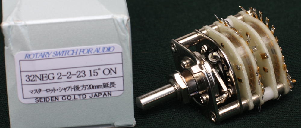

Don't know Peter's opinion but i am seriously disappointed in Seiden. Other than great tactile feel there is hardly any serious comparison to Shallco. One of my Seidens developed some horrible greenish oxidation on the contact surfaces in a very dry climate. Never did any sonic comparisons against Shallco but they just don't last without periodic cleanups.

EUVL said:I thought they have one in square, very much like the Shallco ?
Patrick
Attached :
Yes. That's the one I'm familiar with.
I'm not familiar with Seidens, I got this one recently, included with S&B transformers and didn't even try it yet.

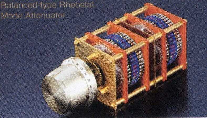

They have larger switches and picture below shows one used in Denon preamp.

Very nice feel. Nice light movement. A snik vs. a clunk of the Shallcos.
Can't compare it sonically to others. It does develop a little noise with motion over time, but turning the knob back and forth can wipe it clean.
I do have some Shallcos that I may try after reading this thread. They have the post terminal rather than the rivit type.
I tend to like very large diameter knobs, so I can turn the Shallcos ok, and the Shallcos do seem more bullet proof. You can also get them custom made. But desoldering 66 TVC leads from the Seiden and transferring them to the Shallco is not at the top of my to-do list.

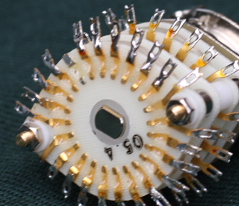

Peter Daniel said:I believe this is what Charles is talking about:
Close, but not quite. The second photo of the "business end" shows the silver "caps" welded on top of the copper rivet. The rivet would be useful if one wanted to insert some resistor leads directly to make a hand-soldered attenuator, for example.
But the first photo showing the backside of the "rivets" is not what we have ever used. Instead, there is a solid copper "turret" (I would call it a post) that we insert directly into our main PCB that contains the attenuator resistors and all of the rest of the circuitry, including the input and output connectors. The result was what I liked to call a "wireless" preamp!
