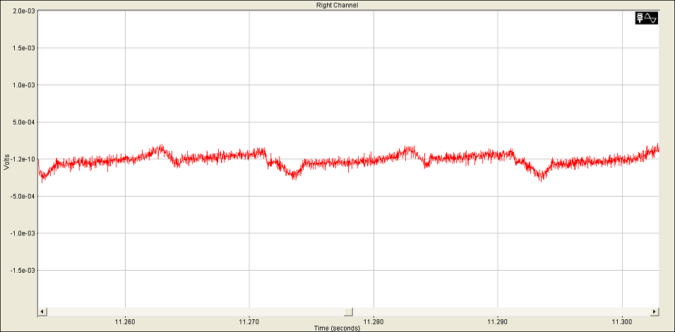

I owe the result with 'proper' grounding scheme. Please compare with
http://www.diyaudio.com/forums/showthread.php?postid=1742422#post1742422
Jan, is there any problem with class II instrument?

PMA said:I owe the result with 'proper' grounding scheme. Please compare with
[snip]
Indeed, looks better. But care to show us the 'proper' grounding scheme, i.e. a schematic. Without such additional info your graphs are pointless.

It looks like the charging pulses @ 50cycles per second are modulating the noise on the ground line.Edmond Stuart said:
Yes, it would be very interesting to see both circuits for comparison and how the test is done so we can check our own builds.
