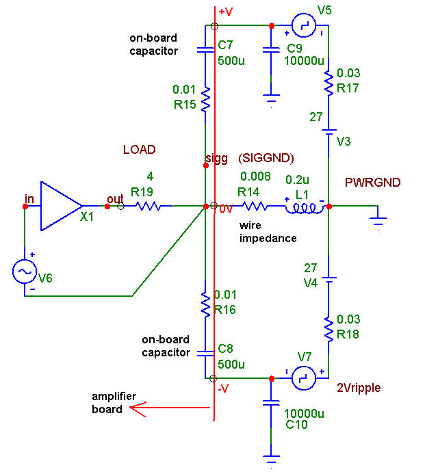

The 'ground noise voltage' I have shown is audible, and influences low level details, low volume listening. It affects localization, and bass perception. Subjectively it affects midrange spectrum mostly. Bass perception is usually more about midrange spectrum, rather than bass amplitude frequency response. The difference compared to proper grounding is audible, and explainable.

how minimize the ground noise voltage or what's the perfect schematic for the ground? Maxpou
Please review the image, and tell me where would you connect the load return - to SIGGND, or to PWRGND?
This simulation tries to describe real circuit issue, and simulation result quite fits to measurement.
500uF are on-board capacitors, amp is an 'ideal' for simplicity, but it is not important at the moment.
It is a high bias amp, more than 1A at idle, so the ripple is always high.

PMA said:Please review the image, and tell me where would you connect the load return - to SIGGND, or to PWRGND?
I can't see a reason to connect it to other than PWRGND, at the point of the red dot, along also with the caps that are shown connected to PWRGND. Do you have reason to connect to SIGGND ? Another alternative would be to use an additionaql channel amp to "amplify" ground and connect to load to the active ground thereby passing the current to the power rails. This seems to be a common approach in headphone amplifiers.
As it is drawn, it seems OK. The signal at OUT exactly follows that at IN, measured against the 0V point if I read that correct. All the other stuff will have an impact on PSRR and such, but not on the signal directly.
The question is, can you connect the input source as drawn?
