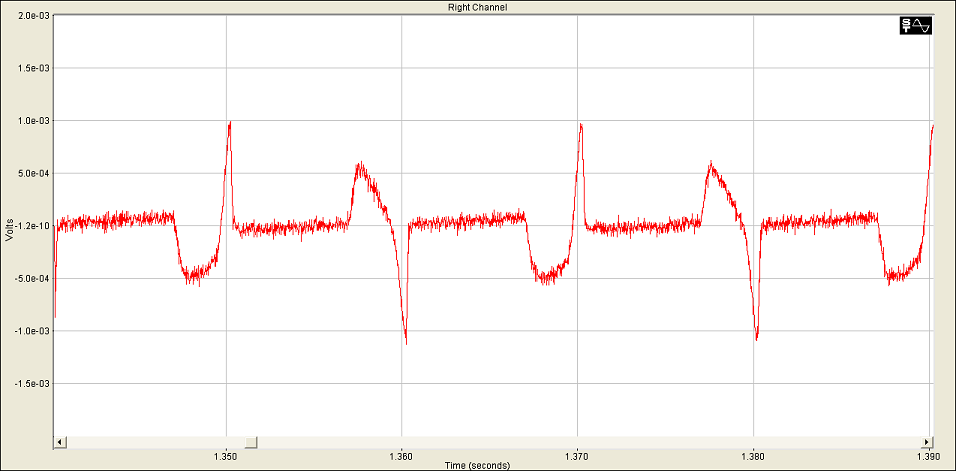

As many of us seem to agree on importance of grounding issues, I would like to show a result of improper grounding scheme, the one that is quite often used. The measurement is done at power amp speaker terminals and spikes are a result of the grounding scheme chosen.
I can comment on a problem later, if there is an interest. I apologize myself that I am quite busy, so not able to be 'permanently' here to reply.

PMA said:As many of us seem to agree on importance of grounding issues, I would like to show a result of improper grounding scheme, the one that is quite often used. The measurement is done at power amp speaker terminals and spikes are a result of the grounding scheme chosen.
One important comment is IMHO: how would you describe from a sonic point of view this faulty way and its cure.
PS: Show us the scheme, we can figure out what's happening.

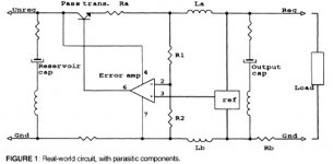

PMA, contamination of signal-gnd with charging-currents of ps-caps ?
People should also realize that most circuit diagrams are not an accurate representation of how the circuit should be physically built,especially wrt. grounding.

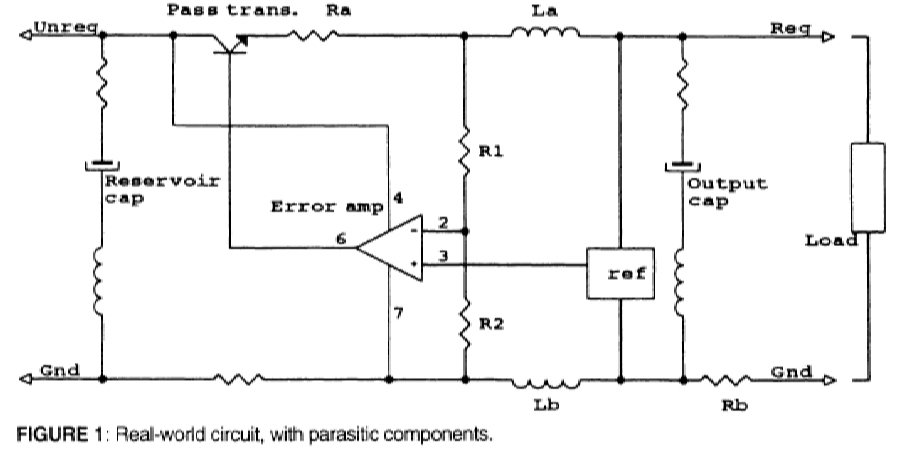

The charging current flow from rectifiers through the supply caps back to the transformer secondary is not part of the signal path. Yet, it is very often a cause for less than optimal performance because of errors in ground paths and/or loops.
The first step should be to keep that loop totally outside of any signal-related return loops, and only interconnect it voltage wise to the signal loops at one point, like the star point.

janneman said:The charging current flow from rectifiers through the supply caps back to the transformer secondary is not part of the signal path. Yet, it is very often a cause for less than optimal performance because of errors in ground paths and/or loops.

The star-shaped ground routing for PSUs is probably the best one.
