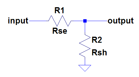

Here's a thought I had a while back for a "pot emulator" consisting of resistors and relays. The basic structure would be that of a series arm Rse and a shunt arm Rsh as shown in the picture below. Each of Rse and Rsh would consist of a bunch of series resistors with a relay across each one that is either open or shorts out its corresponding resistor.
Rse would look like this:
Rse = R + 2R + 4R + ... + 2(N - 1)R
Rsh would be the same as well, namely:
Rsh = R + 2R + 4R + ... + 2(N - 1)R
Suppose there were a digital word Xse controlling Rse such that the LSB of Xse opens or shorts R, the next bit opens or shorts 2R, and so on. There could be a second digital word Xsh that does the same for the individual resistor elements of Rsh.
Now, if Xsh were made to be the bitwise NOT of Xse, the input resistance would be constant, independent of the attenuation. So it would emulate a pot in that respect. The signal would go through a lot of relay contacts with this arrangement though. Has anybody else thought of this or tried it out?

pooge said:
No mention of TVCs?
High input impedance. Low output impedance. Doesn't change the signal to heat. Breaks ground loops. Blocks DC. Can feed it balanced or unbalanced.
This still uses a switch to give the steps. Not much heat generated by average preamp signal levels. There shouldn't be any DC to block. There are other ways to break ground loops that are much less costly. Any type volume control can be used balanced or unbalanced.

You will need a lot of relays, so why not use a matrix instead and fewer relays?
Yes, Matt Kamna has, with 15 steps per channel.and a LOT of relays and some sort of programmable controller to run the thing . 2 channels, custom programmed infra-red remote control, mute function and lighted display showing the setting in big easy to read numbers! Soon to be on the 'open' market, but he already has first production batch sold out in the NW region.
stinius said:
Andy
I don' t think this would be the same thing. Let's say you had 10 relays each for the series and shunt arms (that is, the series and shunt arms would each have 10 resistors). This would give 1024 attenuation states. I'm not sure how you'd do this with a matrix, but I'm not familiar with the relay matrix idea either, so I may be misunderstanding you.
