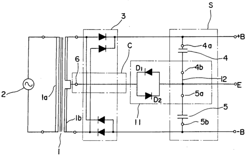

john curl said:I can recommend two approaches. One is to add input filtering, both common mode and differential mode. The second is to add resistance and or significant inductance in series with the center tap of the secondary of the transformer, if it is used.
JC the same for dual bridge config (+/-)?
The capacitance between windings allows for a common mode connection between your amplification system and the power lines, if you connect the output of the rectifier system directly to chassis ground. That's not a good thing.
Adding an inductor to a center tap adds a series impedance that may help.
Reducing the coupling between primary and secondary does help, whether through transformer selection or "neutralization" of the capacitive coupling.
Using a balanced smoothing filter with only the output connected to amplifier "ground" (common, really) also helps.
All this can be modeled - it's plain engineering.
Not connecting the chassis ground to every other electrical product in the neighborhood also is a no-brainer.
If you examine the mechanisms that many amplifier circuits use to optimize PSRR and distortion, many are based around the idea of converting an undesired signal to a mode that the amplifier isn't responsive to. For example, common mode to differential mode. But, if you do anything to allow mode conversion to re-occur, you lose. Look at any text on amplifier feedback application for examples.
BTW - there's a lot of people who swear that power cables make no difference at all. After all, aside from the resistance, what is there? How about the differential to common mode coupling inherent within, especially to that ground wire? That doesn't even consider the susceptibility to radiated EMI.
Input filtering can backfire badly, like the input modules Levinson used. Those coupled the line born noise back to the chassis ground and caused no end of hum problems interconnecting with other products. I would suggest looking for medical rated filters since they are low leakage types.
Finding transformers with low capacitance between primary and secondary is difficult. The Signal transformers with seperate primary and secondary bobbins are better, but the flux density is high in those. using a 220 Primary for 110 and a secondary with twice the target voltage helps at the expense of available power and regulation.
