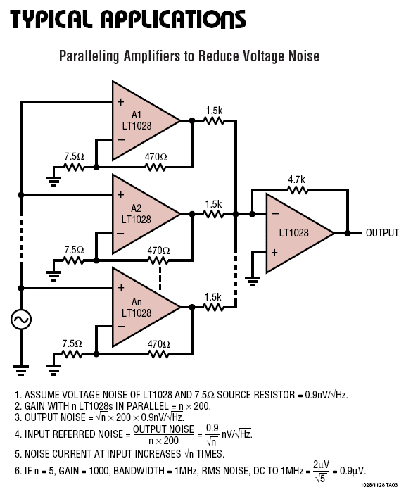

This point has grown tired, it is trivial to make an input device with that low rbb. IC op-amps that idle at 1 Watt have no commercial value except to a few hundred users. We already know how to make an op-amp with .2 nV of noise, please ante up a few thousand dollars for each to cover the costs of masks and wafers.
... or do it as shown in the Lt1028 data sheet,
where they simply parallel half a dozen of LT1028 OpAmps.
That's so old and boring. In the industry, this is
subsumed under "typical applications".

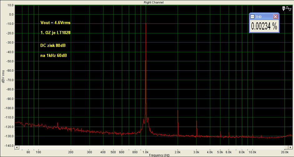

PMA said:
I also had made that measurement (i.e. full linear gain, about 80dB, without RIAA freq. resp.), it had about 0.01% quite exactly. Anyway, not much reason to do it, I agree. Especially when RIAA FB caps add heavy loading for the unbuffered opamp, like in case of syn08's GPP.
