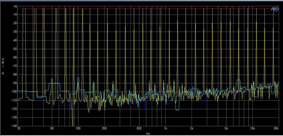

Ok, lets have some fun here. The picture below is a multitone measurement from an amp I'm working on.
The large yellow traces are the test frequencies, 31 total at the same level according to the ISO standard. This signal is used as it has a much closer correspondence to music that single or a few tones. The load is a resistive 8 ohms.
The top line is the freq response derived from all the frequencies in the output signal.
The cyan curve at the bottom shows the frequencies in the output signal which are not in the imput signal. Can be considered as all harmonic and non-harmonic products due to amplifier non-linearities.
The blue curve at the bottom is the output noise, basically everything except the input- and distortion products.
Question: where does this amp need work to make it better, and why?

Power supply. Looks like there's not only some noise from it, but also a bit of signal modulation.
What's the window you use for the FFT?

SY said:Power supply. Looks like there's not only some noise from it, but also a bit of signal modulation.
Ahww! You took all of the fun out of it 😀 !
