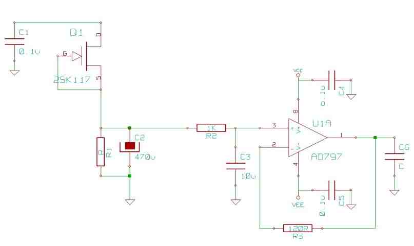

Concerning the quiet supply I posted here previously, which was heavily criticized, here are the DAC's manufacturer Application Notes, recommending similar circuit (Figure 4):
http://www.esstech.com/techsupp/Application_Note_Component_Selection_and_PCB_Layout.pdf
The circuit is repeated below.

Choosing opamp and capacitance depends on each other and of course load, circuit implementation etc.

does a prototype exist at all?Joshua_G said:I updated the supply circuit.
C6 will be between 10uF and 47uF and will be determined in the operating circuit itself, feeding the load.
regards
