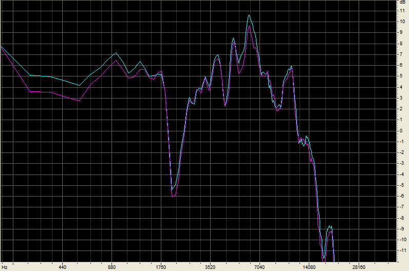

Let me say it with a picture...
Here is a quick comparison of one example. I compared my zip cord to 6' of #30 wire (as recommended somewhere). This is not a fastidious test but I was careful to play the same 1 min of white noise from a Sony test CD through one Sequerra MET7 and a good but not B&K mic. I was very careful to keep everything exactly the same except for the wire. I averaged a full min of 1k FFT's for both. The speaker measured 4.8 Ohms DC and the wire 1 Ohm for casual science I would say 1.6dB loss at the low end and who knows elsewhere. This was nearfield so I guess there was a big crossover dip (I'm not a speaker guy).
The picture agrees (red is #30) roughly, so I agree you certainly can hear the difference.
John, I don't know what all that gear is for, if you don't test wire in situ I don't think it is a very productive endeavour.

Re: Let me say it with a picture...
Hi Scott,
I did a similar thing here more than a year ago, but in my case it was to demonstrate the sonic differences (or lack there of) between different speaker enclosure building materials. My results were called "inconclusive" as they didn't show the information that may or may not be present 40-50db down. Not having the CSD plots for the measurements was a strike against also.
Moral: In the face of all accurate presented data, there will always be an "out", a way to discredit your findings.

Re: Re: Let me say it with a picture...
I was really trying to show the obvious, put 1 Ohm of resistance in series with a 4-8 Ohm speaker and you probably get some of that "valve" sound i.e. someone will prefer the #30 wire. We are not 50dB down in effect here. Yes some will say 1.5 dB down over 5 octaves is not the difference they hear. The big question is if the forum software will break at 1,000,000 reads of this thread.
Also I think in general the skin effect stuff and chasing -106dB vs. -130dB 7ths are witchhunts.

Re: Re: Re: Let me say it with a picture...
Ever tried? You wouldn't.
I thought you were showing the obvious similarity, the lack of difference. The 1 ohm resistance increase may not have been responsible for the deviation. When you say near field, how close did you position the mic? Judging by the null, you were far enough out to get some room effect. What was your position in the room?
Run the test again, but don't add the resistor this time and look at the results. Are they exactly the same?
Position the mic closer and run the test again.
Scott, that is quite interesting, I would have liked to see the comparison done with some more serious cable also. That said, you have measured the difference in peak response only, many of the differences is in low level detail and soundstage focus also, not sure how to measure that.
scott wurcer said:Here is a quick comparison of one example........
