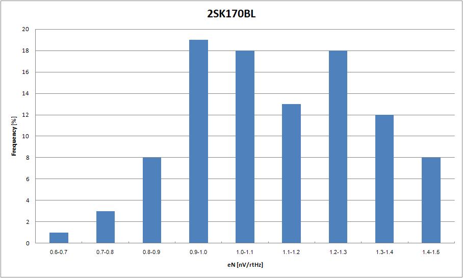

If you have the noise data on paper, I can do the transfer from paper to Excel. Just email me the raw data.
Thank you, I just did it myself.
2SK170 @ Id=5mA (to keep all the population under or at Idss), Vds=10V, f=1KHz, common source.
Edit: 5mA
