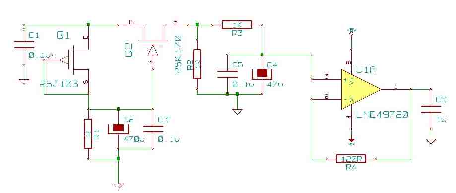

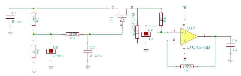

Originally posted by dimitri
remove C4 - it may cause oscillations of the follower
Please see amended circuit attached below.
arrange the feedback network to isolate 1uF capacitive load - it also may cause instability
This particular IC can accept capacitive load.
I'll also make L3 C3 ten times larger, replace R2 with voltage reference and fed it from the output,
There is no need for it, since the input is well regulated.
also your opamp has 2.5uV/sqrtHz, while 2SK170 has 1uV/sqrtHz, I'll replace opamp with AD797 :2c:
This opamp has 2.7nV/sqrtHz, not 2.5uV/sqrtHz – it looks quiet enough.
Originally posted by john curl
What I was trying to point out with C3 is that it MUST be a low impedance at all audio frequencies in order to not see a significant fraction of the 100,000 ohm resistor noise. I would recommend 33 to 220 ohms in that position. As Dimitri pointed out, adding a large capacitor after the follower can make it oscillate, and it won't do much good.
The IC is kind of noisy compared to the 2sk170, and maybe something else that has enough output current, but like 1nV/rt Hz or so would be more appropriate. In fact, you don't really need an IC at all, if you just parallel two 2sk170 devices to get more current.
This IC has 2.7nV/sqrtHz, so it looks quiet enough.

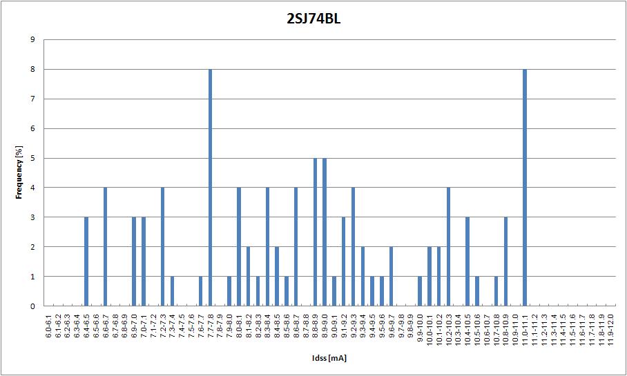

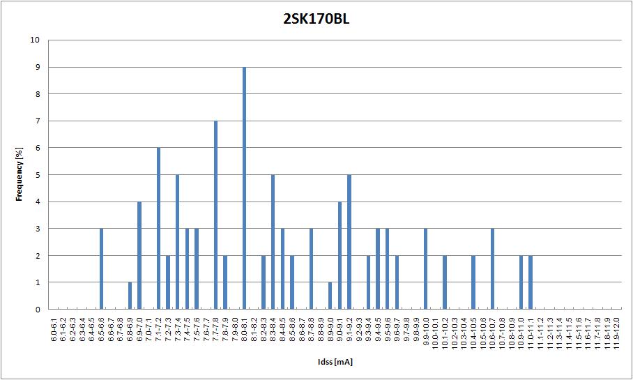

I have at hand the Idss dispersions for both 300x2SK170 and 300x2SJ74. For the noise, I still have to process the data manually, I couldn't automatize the data aquisition.
