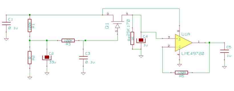

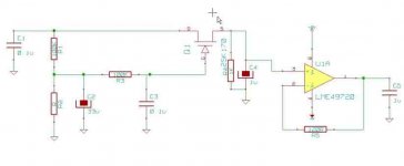

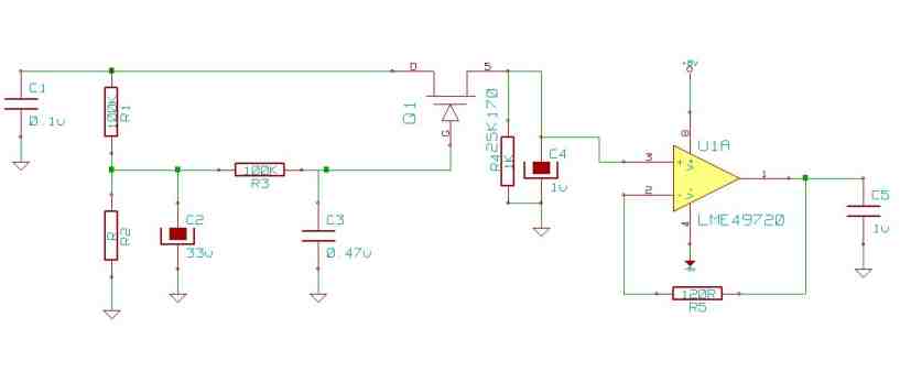

dimitri said:
Sorry Joshua, there might be some errors in your circuit. 🙁
How about this one?

Joshua_G we have problems with this schematic. We can go through it, piece by piece, but it is not optimum at this point. In fact it has too many parts, and is not too quiet.
What I was trying to point out with C3 is that it MUST be a low impedance at all audio frequencies in order to not see a significant fraction of the 100,000 ohm resistor noise. I would recommend 33 to 220 ohms in that position. As Dimitri pointed out, adding a large capacitor after the follower can make it oscillate, and it won't do much good. The IC is kind of noisy compared to the 2sk170, and maybe something else that has enough output current, but like 1nV/rt Hz or so would be more appropriate. In fact, you don't really need an IC at all, if you just parallel two 2sk170 devices to get more current.
