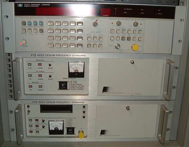

From that other forum
I use 2x FTS4050 Cesium Atomic clocks - phase locked to modified Stanford Research Systems PRS10 Rubidium.
The 2x Cesium's provide the long term accuracy to Stratum 1 Performance, while the SRS PRS10 provides better short term Phase Noise.
The PRS10 was modified for lower LF noise by improving the internal regulator voltage references. John
