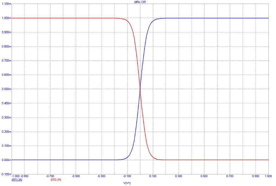

As long as you are unable to specify:
a) the scope of the design
b) the performance metrics and
c) you are imposing your own subjective criteria ("out of my own experience, that it sounds worse than no GNFB circuits")
then chances for somebody to come up with what you would call "a better design" are nil.
Examples:
- if the scope of the design is a line amp for 100mV input level then the noise performance is absolutely irrelevant in any competent design, using modern components. See e.g. Pavel's Dispre design.
- if the scope of the design is a phono stage, then noise performance is critical but anything unde 0.05% distortion is very good. See e.g. my HPS 2.0 amp (BTW, it happens to have 0.002% distortion).
- if the scope of the project is a mediocre design that would be to noisy as a MM phono stage and have to much distortion as a line amp, then you build JC's schematic you just posted and happily live ever after.
One possible approach (where GNFB ALWAYS makes problems):
