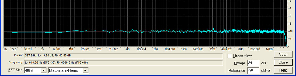

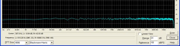

This is a project that I am working on right now. Gain of 60dB preamp connected to an MAudio USB A/D, computer display, several CFL's, regular FL's, 16 - 150CFM fans 10' away, everything plugged into the same isolating strip. Picture of noise floor.
