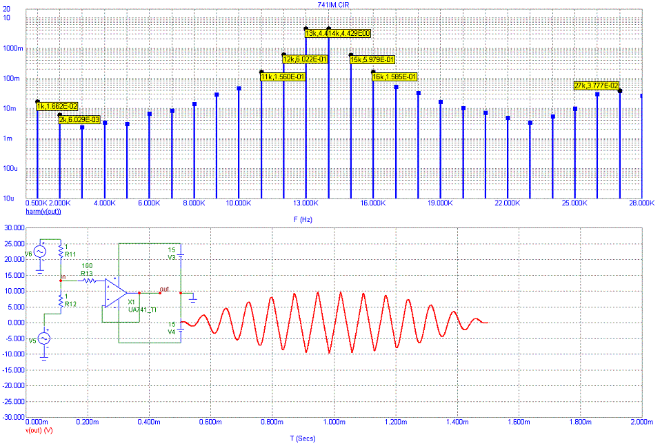

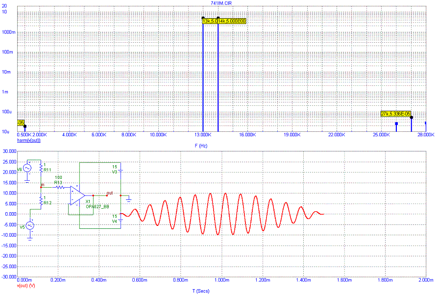

John, I would admit that 3 tone test, or CCIF-IM test reveals TIM, as soon as derivative of test sines approaches to slew rate. The reason is that test signal changes in amplitude, with repetition frequency F2 - F1.
PMA, it is difficult for me to determine what test you are doing, but if you look at our AES Journal paper, April 1977 p.172, you will see a comparison between a simple multi-tone test and a Sine-Square multi-tone test in Figures 3 and 4. The only significant difference is the rise-time.
John, it is the standard 2-tone CCIF IMD distortion test, 13+14kHz in this case. You know, this signal resembles 100% amplitude modulated sine, and slope (derivative) at zero crossing changes during period.
I know the paper you speak about, I am just trying to mention that different methods reveal the same problem, as there is only just one non-linear transfer function of the non-linear system; and this function covers slew rate as well; the case is to make a choice of the 'right' test signal, that quickly reveals issues.
