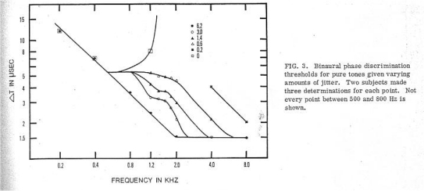

Most of the researchers use headphones, so refer to the testing as lateralization tests. I've not seen any studies that use a single speaker as the reference with two speakers setup as the stimulus for testing IID/ITD. That would be too close to what we actually do, wouldn't it??
Typically, the graph that comes out is like this:
Now, this is single tone with the subjects determining a difference. Other research also indicated the ability to be trained to get to this level of discrimination.
My point RE measurement is...do you think you could easily find a sibilance interchannel delay of even 5 or 10 uSec, with drums, bass, vocals, guitar, snares, tanbourines, piano, organ, some of it not correlated interchannel, or even with identical frequency distribution? This is a signal correlation mess...but humans do seem to be able to discriminate stuff like that..
Cheers, John

jneutron said:Typically, the graph that comes out is like this:
I would have been most interested in data down to 50 Hz or so.

I've never seen papers going that low. I would suspect one would have to use a sinex/x style impulse to test, otherwise the transient nature would allow keying on harmonics of the test signal, rather than the fundamental..
The Nordmark graph is log/log, and it appears to be a straightline on those scales..
I printed it out and extrapolated...at 100 hz, it's 25 uSec, and at 50 hz, it's 45 to 50 uSec.
But I've no idea if that extrapolation is even worth the time to type it.. Chances of that extrapolation being even close is probably zero..
Cheers, John
jneutron said:I printed it out and extrapolated...at 100 hz, it's 25 uSec, and at 50 hz, it's 45 to 50 uSec.
Steven Dear has previously informed me that the consensus for phase
sensitivity is 200 to 2000 Hz or so, the sensitivity of the top falling off due
to relaxation constants in the ear, and the bottom due to long wavelengths.

If you look at the graph with zero jitter, it looks like a bathtub, and a threshold of 15 uSec unjittered is between 200 hz and a tad over 1.2 Khz. Unjittered, Nordmark certainly agrees with Steven.
The truly amazing sensitivity with jitter is the weird part. It looks like the kind of thing we get when we dither an analog signal in front of a ADC to increase sensitivity beyond LSB..
How to interpret that in terms of the "hunter" in us....beats me.
But it would appear that this would have significant impact on a single driver system, or one where the 200 to 2K information is coming from the woofer cone, as the woofer displacement will certainly impact the jitter of the mids..
Cheers, John
