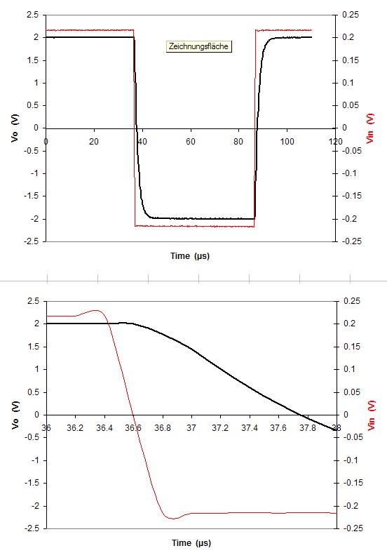

Output (3rd) stage is the Curl complementary JFET follower using 5 pairs of 2SK170V/2SJ74V with 70mA total bias at Idss. I would love to try a MOSFET version as it would be easy to increase bias / voltage / bandwidth with MOSFETs. This is also why I was asking for a MOSFET version of the follower earlier (Post #779). But no one else came up with something different; so either I was on the spot, or totally silly.
Bandwidth is around 105kHz with the 10k input resistors. But as soon as you shunt (for attentation) across the two, you get 350kHz easy. (Proven on the scope).
I shall try to post a schematics and some pictures, and oscilloscope plots later.

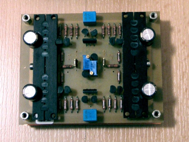

Wow, your boards look fine!
Did you ever do a comparison soundwise to the original EB116?
Uli
Uli

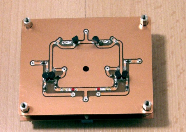

To give you another temptation (picture).

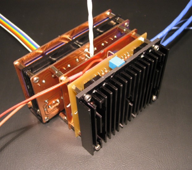

Hello, EUVL
Very impressive work indeed... Congrats !
I love your paralleled Jfets heatsink... And I also think that it was home made... BTW I had a similar but simpler work I stopped because of heatsink unavailability (50 paralleled !!!).
The idea was borrowed from an Italian amp that used over 100 small TO92 transistors to run a low power amp... But still curious on how you made it (drill + halfmoon grinding ?).
Anyway, thanks for sharing good pics !
Jbaudiophile 😀
Jbaudiophile 😀
Only heat distributor. The heatsink is over the entire board and also contact the test of the TO92 transistors on the top surface.
They are manufactured using CNC wire-cut EDM, then black anodised. I have access to a very well equipped industrial workshop.
Patrick
Patrick
