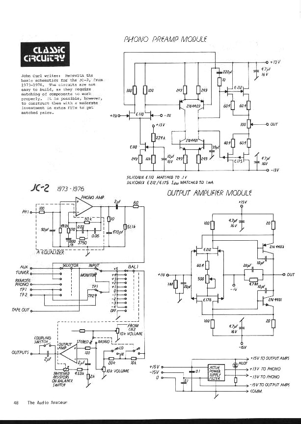

Schematic of the series regulator idea based on the LM3886.

Why are you scratching by left hand beside right ear, Richard ? 😎 You can do it with one opamp + one darlington... 😉
Yes you are quite right !!! Except the voltage handling, the push pull design, and the simplicity, I like very much your “Why are you scratching by left hand beside right ear” expression

Hi, Upupa & Richard,
Interesting schematics... Mostly because it is a rational use of now inexpensive parts to go further the usual LM317 family limits with good specs...

It is not good example, JB... LM's family of power amps are, due technological die's limits, still only quasicomplements, with all disadvantages, which have this connection.... 😉 Lets rather talk about " adult " amps.... 😎
Perhaps there are better chip power amps choices for this purpose (PSU series regulation), for the moment it’s more a generic term for a chip amp to me, and also because a lot of people here seems to appreciate it (as a good and cheap audio power amplifier).
In fact it would be interesting to test the few chips available on the market corresponding to the PSU specifications: power, voltage, current, noise bandwidth and stability etc...

If you mean PS, so there isn't big choice ( if you mean to use power opamp ), 'cos all are quasi... But ideal should be to use LM 4780, one ch. noninverting and second inverting + common reference voltage... Reference voltage must be low, 'cos this amp isn't stabil by low gain...

I only half agree with you here...
It is true that LM series can't achieve full symetry due to its quasi-complementary output stage topology...
But Richard's idea is interesting, as I used a close one for spliting a single supply voltage into symetric ones with little parts... I used a L165 at the time.... I just referenced the non-inverting input to the single power supply midpoint (with 2 equal resistors), tied the inverting input to the output with only a series 1 ohms & 0.22 uF return to the incoming "zero volt" branch (that became -V at the output)... Was done !

Richard's schematic don't make floating ground ( although it can be used for it ), it is normal VR...
