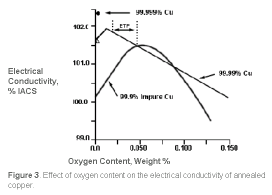

Edmond Stuart said:
According to Wikipedia:
"Oxygen plays a beneficial role for improving copper conductivity. During the copper smelting process, oxygen is deliberately injected into the melt to scavenge impurities that would otherwise degrade conductivity.
See also: http://www.copper.org/publications/newsletters/innovations/1997/12/wiremetallurgy.html#xgncntnt
PS: Mexcel is using copper containing <1ppm oxygen.
So, Edmond, if I read that graph correctly, going from 2N to 5N copper in my cables reduces the cable resistance by a whopping 2% or so! As the man said, well worth the price 😀 !
Edit: I found this secret recipe that does the same. I cut 4 inch of my 15 feet length speaker cables. What do you know: a 2% reduction in resistance! And it's free!

What I was confused about earlier is the deliberate use of oxygen to remove or isolate impurities in copper, and later apparently releasing much of it in final production. Then, there is the question of oxygen free copper and what it means, as well as linear crystal copper, and how it is made.
Re: Oxygen free copper?
This is called "intrinsic gettering" and it's a little more complicated than it looks at the first glance.
"Intrinsic gettering" means impurity trapping sites created by precipitating suprasaturated oxygen out of the cristalline lattice. The precipitation of suprasaturated oxygen creates clusters that continuously grow, introducing stress to the crystal as this happens. These stresses may eventually reach the point where they need to be relieved and dislocation in the crystal are formed to provide the necessary stress relief. These dislocations subsequently serve as trapping sites for impurities, which in turn may have a positive impact on the crystal conductivity properties.
The key issue here is the oxygen concentration. An optimum exists, which for metal crystal grains conglomerates is pretty difficult to reach and control. To much oxygen and you fall on the other side, where the crystalline grains develop oxidized interfaces affecting the overall conductivity. Therefore, to the extend that I am aware of, nobody is relying on oxygen intrinsic gettering to improve the metals conductivity. It is much effective to completely remove the oxygen.
It's a different story for semiconductors. I recall the early days of silicon technology when scratching the back of the 3" wafers with a diamond stylus was the method of choice to create stacking faults acting as getter sites for silicon. Then phosphorus back doping, then polysilicon back deposition and I had a chance to experiment back oxygen implantation processes, to induce intrinsic gettering.
