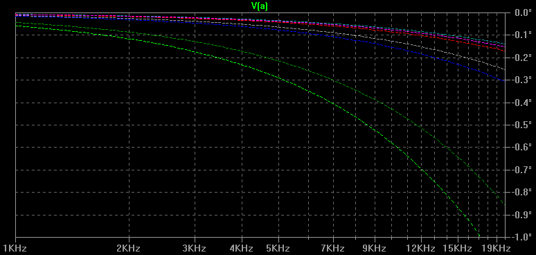

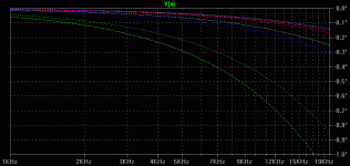

Maybe you missed my Post #6530, where I just tried that, showing only the closed-loop amplitude response vs bias. Now here, for the same test conditions, the phase plot from 1kHz to 20kHz, showing some 1deg max delta between different DC bias values.Bob Cordell said:Hi Edmond. Yes, it's just a guess of mine that doing an AC analysis with different DC offsets would reveal PIM. I have not tried it yet.
