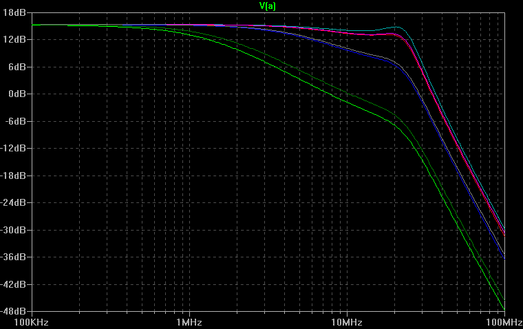

Exactly. See attached plots of closed-loop gain vs DC bias at input (0V, +-1V, +-2V, and +-3V -- 3.2V is the clipping limit) of a simple amp with moderate "semi-global" feedback and common source MOSFET outputs. The increasing output capacitance with lower Vds is most probably the root cause here. Differences from bias polarity, emphasizing P-ch vs N-ch differences can be seen, too.Bob Cordell said:As good as SPICE is, I agree that it may be difficult to find PIM with confidence in SPICE transient simulations. However, it may be possible to infer PIM from phase shift changes in an AC simulation where the DC operating point is moved around on a DC-coupled amplifier.
- Klaus

Phase Intermodulation Distortion (PIM) is not really that difficult to understand. PIM is simply the dynamic change in amplifier transfer function phase shift as a function of signal. This is analogous to common SMPTE Amplitude Intermodulation distortion (AIM) where the incremental gain of the amplifier is a function of signal excursions. The test for them is the same. A large low-frequency signal, typically 60 Hz, is used to cause the operating points in the amplifier to traverse a large-signal range. A smaller signal, typically 4 times smaller and at a high frequency like 7 kHz then has its amplitude and phase modulations measured. Modulation on the small signal at 60 Hz or its harmonics is either AIM or PIM depending on whether amplitude or phase detection is used.
Amplifiers without negative feedback have PIM. One common source of PIM in an amplifier without negative feedback is nonlinear junction capacitance that changes the bandwidth, and thus the phase shift, of the amplifier as a function of signal swing. Miller effect in the VAS from collector-base junction capacitance is an example here. Another source can be the changing ft of the output transistors affecting the bandwidth as their ft droops at signal extremes. The main point here is that the PIM is pretty much directly related to modulation of the bandwidth of the amplifier by signal excursions. When the signal modulates circuit parameters in such a way as to reduce the bandwidth, then phase shift through the amplifier increases. Note that a given percentage change in bandwidth will cause a smaller amount of in-band phase shift if the 3-dB point being modulated is at a higher frequency.
The case for feedback amplifiers is very similar. In this case, dynamic changes in the closed-loop bandwidth of the amplifier cause the modulation of the phase transfer function of the amplifier. That leads to PIM. There are a couple of interesting twists, however. First, the application of negative feedback in general tends to reduce the effects of open-loop variations; it tends to stabilize gain and phase and bandwidth in going from the open-loop condition to the closed-loop condition. To this extent, NFB tends to decrease the PIM that would have been naturally present in the open-loop amplifier without feedback.
On the other hand, the application of NFB causes a conversion from open-loop AIM to closed-loop PIM to occur. As the open-loop gain of the amplifier varies with signal excursions, we know that the closed loop bandwidth of a conventionally compensated negative feedback amplifier will change. So at signal extremes, if the open-loop gain decreases, for what ever reason, the closed loop bandwidth will decrease, and more in-band phase shift will result, and this is PIM. This is no different than saying that the closed-loop bandwidth of the amplifier is changing with signal, just as in the case with a no-feedback amplifier.
In either case, it is just a matter of how much the closed-loop bandwidth changes with signal excursions and how far out that pole is. At this point it is important to recognize that, to first order, a 10% reduction in open loop gain due to signal excursions will cause an approximate 10% reduction in closed loop bandwidth whether the amplifier has wide open loop bandwidth or narrow open-loop bandwidth; the rolloff slope of the NFB at high frequencies is approximately the same in either case if both amplifiers have the same nominal gain-crossover frequency. But the higher this gain crossover frequency, the less PIM will be created by a given percentage modulation of the open-loop gan.
Another twist reveals itself when we examine one of the oft-cited sources of open-loop gain modulation that can lead to closed loop phase variation and thus PIM in negative feedback amplifiers. Consider the input differential pair. When it is stressed by large signals, its gain decreases. The larger the stress on the input stage, the greater is the potential source of PIM. Consider what happens when we have two NFB amplifiers with the same gain crossover frequency and nominal closed-loop bandwidth of 1 MHz. The first amplifier has a wide open-loop bandwidth of 20 kHz. It has an open-loop gain of 34 dB from 20 kHz on down to DC. The second amplifier has a narrow open-loop bandwidth of 2 kHz. It has an open-loop gain of 34 dB at 20 kHz that increases to 54 dB at 2 kHz and is constant from there on down to DC. Assume that both amplifiers employ the identical input differential pair stage. The amplifier with higher negative feedback and lower open loop bandwidth will actually stress the input stage far less than the amplifier with wide open loop bandwidth. The error signal applied to the input stage at frequencies below 2 kHz is ten times smaller than in the case of the amplifier with wide open-loop bandwidth. This means that this source of PIM will actually be smaller in the NFB amplifier with higher open-loop gain and lower open loop bandwidth.
