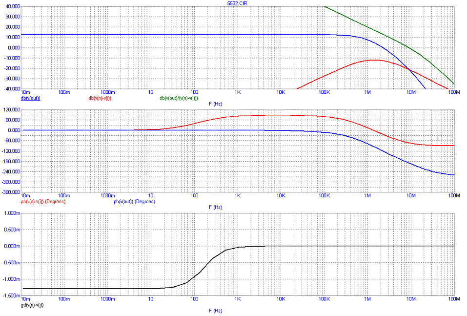

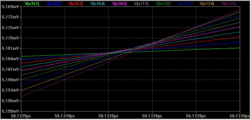

It is a sine of constant frequency with amplitude as a parameter. Magnified zero crossing. Example was for 100kHz, but you find it for 10kHz as well. 5532 is a spice model. You can get any VFB opamp, or discrete VFB dominant pole compensated. You do not get it from passive RC of same BW. And you do not get it from a structure with such Bode plots (v👎-v(i) is differential input voltage):
The problem is only a question of a measure, just magnify to find it. And it is logical - read Walt Jung Paper.

PMA said:The problem is only a question of a measure, just magnify to find it. And it is logical - read Walt Jung Paper.

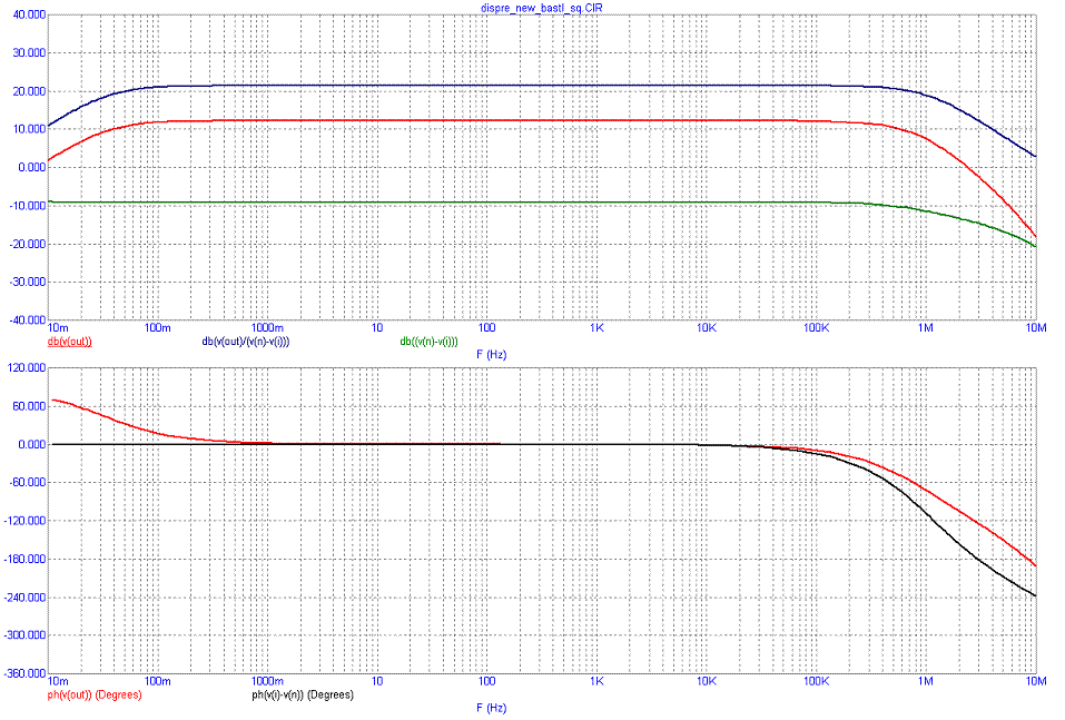

With my basic 40V/us SR, 1.3MHz BW opamp I need to zoom the horizontal scale in to a span of 10ps to see the jitter (which is <2pS overall for 1V to 10V peak output) with a 20kHz sinewave.
If I extend the unity loop gain frequency (which can be easilly extended several MHz without stability issues) by reducing the value of the miller compensation capacitors the jitter reduces proportionally.

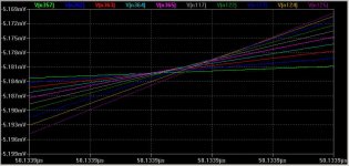

I don't know how to measure it with real devices at this time, PMA, but it is EXACTLY what we would have predicted from the mathematics of Matti Otala almost 30 years ago, and the following analysis by Barrie Gilbert. Just like jitter.
Thinking a little and playing with ideal sources and distortion mechanisms in LTspice, I now found that I get these ZC shifts whenever a distortion mechanism is followed with anything that doesn't have constant group delay for the frequencies covered by the produced harmonics.
Something like a plain x+0.001*x^3, around the corner freq. of a simple RC lowpass. Or if the lowpass itself is somewhat nonlinear. It's not a feedback vs. no feedback question.

Not boring to me, but I have known about it for decades. This is one of the major factors in our more radical design departures from the simple op amp model that we know so well.
I now found that I get these ZC shifts whenever a distortion mechanism is followed with anything that doesn't have constant group delay for the frequencies coververd by the produced harmonics.
