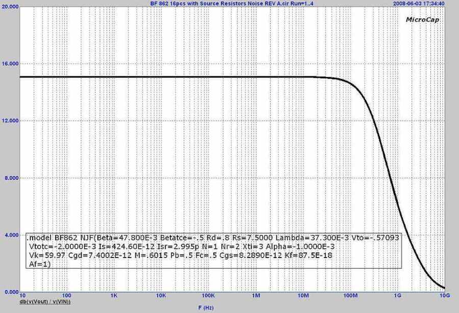

Same design but without source resistors (and drain resistor unchanged for easier comparisons) is attached.
en is now down to 0.17nV / sqrt(Hz) at 10kHz.
I thought that THD would increase but it doesn't.
Sigurd
Another Zen is born. I'm surprised that it is not oscillating at 500MHz or so. I don't know how they get the parasitic C's so low on this FET.
Scott - yes, it is a simple circuit and nothing to write home about, but that was not the purpose either. I wanted to show how many
JFETs would be needed to make a design with approx 0.25 nV/sqrt(Hz), and also to show that SPICE can be very accurate and useful for doing noise analysis.
The design is neither DC-coupled nor complementary, so it is not my style actually.
The BF862 is actually an RF-JFET and not made for audio at all,
but it can be used for our applications, too. It's low capacitance is extraordinary.
It has a "brother" in the BF861A/B/C which does not have as low noise as the BF861 but has other merits instead.
Price for these JFETs is low, very low.
Attached is a freq resp graph up to 10Ghz.

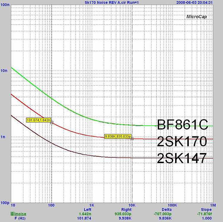

Sigurd, while I applaud your effort, please understand that it is 40 years old. Even the parts that you chose were essentially available at the time, as the 2n4416. Ampex used to buy them for video cameras with preselected 100Hz noise maximums and we used to parallel them, just like you, in 1968, and we then realized that this was possible and almost practical. I suspect that you will find REAL PARTS slightly worse than the parts that you have modeled. Just a word of warning, due to long experience.
John,
yes, I know. It is frustrating for me not to have more skills to get a low noise amp without parallelling loads of JFETs.
With today's parts,
is there ANY other way to get this low noise?
While I am at it, I attached the en for BF861 vs 2Sk170 vs 2SK147. Observe the log Y-scale.
I do miss the 2Sk147....
Sigurd
