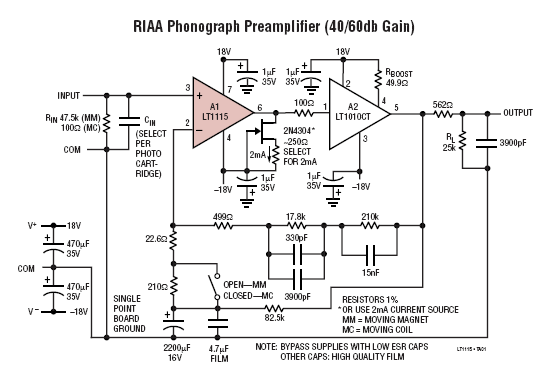

Mr.Curl,
As I see it, the current source solution helps but is it optimal? Maybe the current sorce followed by the buffer is, but my contention is that by the time you go through this would building a discreet circuit might have been easier.
Jam

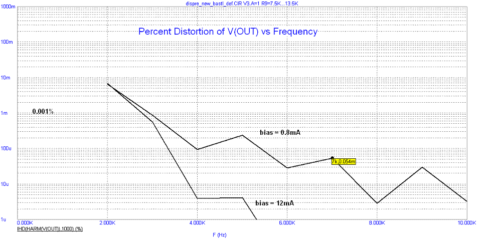

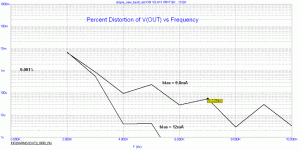

I have just reduced, in simulation, bias of my output buffer to some 300uA. Load is 600R. I made a distortion analysis, that is pretty nasty. Then I added current sink at the output. It helps, but not completely. I get all the harmonics, including the 7th, with decaying amplitude according to their order. No way it can be compared to a buffer with 10mA bias. No hi-end output stage at all.

Thanks, PMA, you have done me a great service. I am poised to measure the distortion, but I can't find any 797's around here to test. I have been originally set-up with a 5534, just for getting the bugs out. Now I am ready to finalize the design. No extra buffer stage for this design, just the minimum that I can get away with, WITHOUT adding 7th harmonic to the mix, if I can help it. I can't even find a LT1028 at the moment. Darn, I will have to order some.
I had hoped to bypass actual measurements, but to no avail. Thanks everyone.
