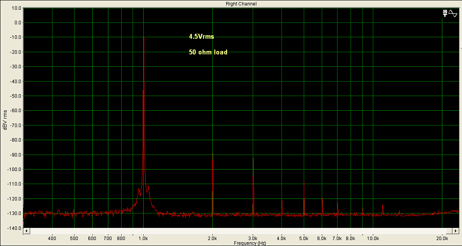

In any class AB-2 output stage, 7th harmonic is an easy probability. In fact, it is almost impossible for it not to be there. This is because it is almost impossible to make a perfect transition between one device turning off and the other turning on. Even idealized curves show this to be so. IF you have only 0.5ma Iq on your output stage, because your current budget has been used elsewhere, and you have to drive a 600 ohm load, for example, then you MUST get a transition at about 0.6V out, peak. If you are below this peak, then you are still in the class A region (more or less), but if you exceed this level then you must go through a rough patch. How rough is my question, since I expect at least 12V peak voltage or 20 times more level, before I might find another source of serious distortion in this output stage. Can you appreciate that 20 times lower level than peak is about where the average signal may actually be in a real circuit? Is it so mysterious, or difficult to comprehend why I ask this question?

With 4.5Vrms and 400R load I am in class A, for the reason of 11mA bias. Till 22mA peak, the output stage is in class A. That means, for any real life line stage load, it is in class A for any output amplitude below clipping.
Here we go. Now I have forced the output stage into AB. The load is 50R + 3R series resistor = 53 ohm. Again 4.5Vrms.
FB is only 10dB, so it does not suppress high orders much.
You can see the 7th. Most line stage outputs would collapse under these conditions.

Excellent "tutorial", Pavel.
Thanks for sharing.
Finally, the 7th is there - and more even so the 9th. I think that
John mentioned the 9th somewhere else in this thread, and the 9th is also a "nasty one".

PMA said:Here we go. Now I have forced the output stage into AB. The load is 50R + 3R series resistor = 53 ohm. Again 4.5Vrms.
Just for the record, I have played with the sole output stage in simulation. The 7th has appeared after the O/P has left class A, exactly as John had said. There was no 7th even for higher amplitudes, in case the output was kept in class A.
It helps me simulate what Scott's output stage is really doing. You will never learn anything more about the Blowtorch from me, so you had better get used to it. Actually, I can extrapolate from PMA's work, already done, myself, but the rest of you might have more difficulty. That is why I asked PMA to help me teach the rest of you something useful and important. Mainly, that Class AB-2 designs usually generate some measurable amount of 7th harmonic. 7th harmonic is the most critical harmonic that generates real problems in hi fi reproduction. Personally I use 50ma for my discrete preamp output stages, therefore I have no problem with 7th harmonic, but I am forced to use these IC's for an inexpensive phono stage. What a headache.
