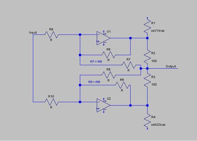

Just thinking out loud, forgive me if this is stupid.
Can you sum two Op-Amps, whose outputs are biased so that the N stage is conducting in one and the P stage in the other? Seems you could use a moderate value summing resistor pair (few hundred Ohms?) because the way op-amps work only a small offset voltage will bias one half pretty much off. Since the two outputs will be nearly identical there will be only a small drop on the summing resistors. Take the feedback for both Op-Amps from the summing node this should return the output Z to near zero (watch out for compliance issues).
Parts count will be up, but at least no matching would be needed and any output stage crossover distortion should approach zero.

like this?
http://www.head-fi.org/forums/f6/ad8397-class-188758/index2.html#post2264079
up and down in that thread I show some more ideas and photo's of the amp internals - I will admit that stacking op amps in the "totem pole" output stage to double the Vswing does wander off into the too much complexity domain

Exactly this I have proposed here. With normal line-level applications one almost always needs some isolation resistors on opamp outputs anyway, therefore there is seldom a true need for wrapping the feedback around the resistors. There are many other ways to have two or more outputs arranged in a push-pull fashion across amps, I've seen a few in this forum, just can't find them anymore.hermanv said:Just thinking out loud, forgive me if this is stupid.
Another tiny opamp trick I've used is normal class A biasing with a resistor or CCS, typically to the neg supply, combined with a second opamp in the same package (thus for duals) that inverts the signal of the first opamp and has the same total load conditions but is is not really in the signal path, being just a load balancing dummy. Then total power supply current in each individual rail is constant, which lessens the demands on the supply bypassing quite a bit. With a known load for the first opamp this constant current draw can be made virtually perfect. And the addtional cost and effort is really low, especially with the good old 5532 (which is much better than its reputation when used with optimized conditions).

I don't see a DC bias current on both output devices. As I described my idea, it won't work because the offset current simply flows through the totem pole resistor stack and not into or out of the Op-Amp output stage.
What's needed is a feedback for each Op-Amp (neg. and pos.) so that the output voltage stays near zero for no signal. The lion's share of the feedback would come from the summing node with a litle coming from the actual Op-amp output lead. This will make the voltage output near zero, forcing the offset current to flow into or out of the Op-Amps
jcx said:like this?
On second look (dinner break) I do see the DC bias. I guess I'm knee jerk opposed to the diode, have you run distortion analysis? Built it? listened to it?
In all fairness I've done none of those things with my post, just hobbyists trading ideas 🙂 🙂.
