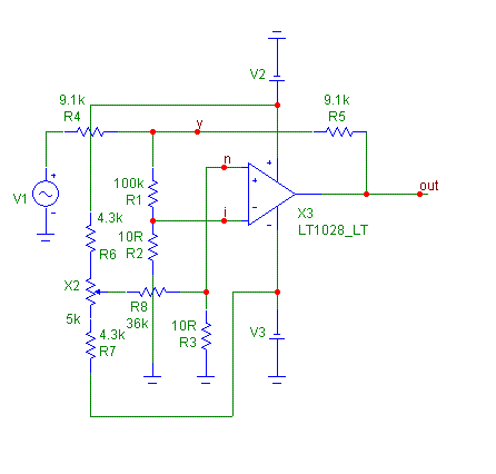

Yes, I did. I am attaching my test circuit. OPA211 outperformed LM49710/4562 in noise, 211 has about 10dB less noise. Also, LM noise tends to increase for LF. For me, 211 is much better chip, than LM. The LM is quite sensitive to demodulation/detection, and is worse in PSR EMI. For me, not the chip to use.

I know you don't like the National LM4562 and LME49710; from where I sit, I was unable to find a shred of objective/measurable of evidence against these opamps (for the application I was looking for).
For a MC/MM preamp I would definitely go with OPA211.
I am sorry but I don't think the alleged RF sensitivity (BTW I was unable to measure anything like, using an industrial test jig) makes any difference to audio performance. Its just that OPA211 has, as you mentioned, lower noise and slightly lower distortions.
