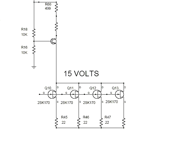

john curl said:Grey, it is again a language problem. 51 ohms gives low Iq and slightly higher noise. 10 ohms gives optimum Iq, BUT not optimum degeneration, so you have to add the 5th resistor of 200 ohms or so.
John, 10 Ohms is the optimum value I guess for a line level input or so (0 / -10db), but will you also use this value for lower levels, mic or an MC preamp? I would use a smaller value (gain, linearity and noise purposes) but not less than 3.3 Ohms, as in the example below:
MC preamp Part2
I think that many of us (me at least) biased by the picture expected a very specific input stage arrangement ! Probably why so many questions about it !!!
I know a famous example similar to yours but with 2x 2SK147/2SJ72 at the input. They feature 6R19 from the junction of the 2 sources to gnd. From One source junction to the other there is a 20R trimmer with wiper to gnd. In total is this about 7,5 - 8R from each source to gnd and this circuit is one of the most famous phono input stages.
Nelson Pass used 22R but for 2SK170GR.
Uli
I believe he said he was using 2SK170BL devices.

GRollins said:I believe he said he was using 2SK170BL devices.
I wonder how he manages a draincurrent below 3mA per device with 22R and BL type
Uli
I'm not sure where you're getting the 3mA figure. It's been a while since I looked at the Ono schematic, but I seem to recall that they're running at around 5mA each.
Grey
Grey
Grey,
Between the base of the cascode and Vb are about 13Volt. When you look at the resistor between collector and Vb being 1k its not possible to have a collectorcurrent higher than about 12mA.
Uli
Uli
