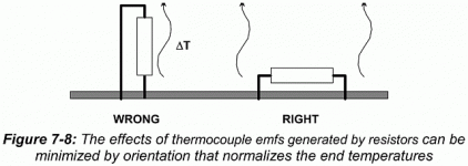

Taken from Analog Devices HARDWARE AND HOUSEKEEPING TECHNIQUES .pdf
Regards
James
Figure 7-8 shows (see attached) how resistor orientation can make a difference in the net thermocouple voltage. In the left diagram, standing the resistor on end in order to conserve board space will invariably cause a temperature gradient across the resistor, especially if it is dissipating any significant power. In contrast, placing the resistor flat on the PC board as shown at the right will generally eliminate the gradient.
An exception might occur, if there is end-to-end resistor airflow. For such cases, orienting the resistor axis perpendicular to the airflow will minimize this source of error, since this tends to force the resistor ends to the same temperature.
Note that this line of thinking should be extended, to include orientation of resistors on a vertically mounted PC board. In such cases, natural convection air currents tend to flow upward across the board. Again, the resistor thermal axis should be perpendicular to convection, to minimize thermocouple effects. With tiny surface mount resistors, the thermocouple effects can be less problematic, due to tighter thermal coupling between the resistor ends.
Regards
James
PMA said:Stand up resistors are a poor practice, one gets high lead inductance of resistors.
Lead inductance? Hahaha, add DC voltage too as a result of different temps at both ends!!
It also makes a good antenna, teflon tubing or not!
AndrewT said:is it as bad as that?
It is that bad from many points of view, as already written here by many. In professional practice best avoided.
Assuming that the resistor is non-inductive, hence some variation on a helical resistive pattern on a glass or ceramic substrate, then no, the inductances going up through the body of the resistor and down through the straight lead will not cancel. They design the body of the resistor to cancel inductance, not the leads. What happens to the leads is up to the board designer.

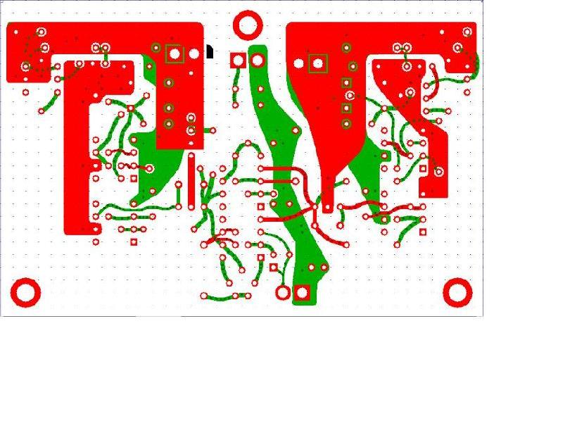

Once again, and I'm sure to be thought of as mis-guided, I’m only dealing with audio frequencies and DC.
Think about where the need for DC to light bandwidth comes from. If you can control that, your circuits are processing audio frequencies. The layout has a big part in this.
The trade off that I’m making here is for a much tighter layout of the sensitive part of the circuit by adding an extra 5-6mm of lead on the supply side (essentially ground potential if implemented correctly) or the low-Z nodes. My take is I’ll have stability issues if my I’m wrong.
The interesting thing is, if it is a bad choice I’ll hear it or see it on the PC, then I’ll have to layout another board and confirm it. 3 boards $55. One to get it working and two to build up and listen to.
Like I said, sure to be thought of as misguided, but I'm happy trying something and seeing what happens🙂
My main concern right now is whether or not I'm going to need a servo and how best to build one in. I can't order the boards until I'm happy.
Regards, Mike.

Hi Mike,
I've looked at that same app. note. How does it sound? Also, I haven't studied your layout. Did you build the full passive EQ version?
-Chris
-Chris
anatech said:Hi Mike,
-Chris
Hi Chris,
I built the active/passive version. It was a coin toss decision based on always listening to fully active EQ. Sonically it's very clean, well balanced and most notably low distortion in the high frequencies. My gut thinks that it has a bit of trouble resolving low level detail; missing a bit of airyness and possible blurring over of stuff I remember being more distinct, but that could also be caused by so many other things, poor recall, etc. All in all it's actually quite good. I've enjoyed listening to it. ( I posted a picture of it a few months back).
I'm working steadily at a discrete Jfet design and when it's done I'll get more serious about dialing in the setup (arm, cartridge suspension, grounding). right now I'm just listening to music and having fun.
The interesting points in the layout, to me, are the low-Z supply nets and the minimalist signal path. Regulated supplys are individual loops with single outputs across the audio circuits with no output caps or bypassing needed. The FFT on the supplies are perfectly clean and below -110db (my resolution floor) the National chips do the rest.
I was experimenting with cascoding the supplies based on Walt Jungs Audio amatuer articles. Very effective. The images are also an older version than the boards I had made because the cascode is missing from the negative supply. I kind of chose the image at random.
I was looking for a reference point since I don't pretend to be anything more than servicable at circuit design; not anywhere in the league of John or Charles. I wanted to try my hand at a Jfet preamp for my MC cartridge and I need something to tell me if I was in the ballpark once I fired it up.
Regards, Mike.
