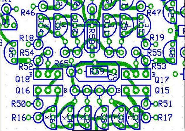

My approach is to highlight all of the sensitive nets on the schematic and to use this as a guide for placing the components. I keep the +/- supplies as straight shots down either side of the stage, with ground running below (if possible) and try to arrange the placement of signal ground leads to a common point, not snaked around. I also identify all of the functional loops and try to keep them as small as possible. Most Hi-Z nets have very low currents so you can minimize the effect of the DA by keeping their footprint small. Also use the exact footprints of the parts you are going to use, as there is no cheating the space God once the board is made.
This is a simplification, but once you have all the components on the screen and start to try different scenarious it can become quite interesting. I find my self analyzing moves and their effect in the same way you would play a game; all based on the knowlege gained through the various books listed earlier and experience.
I've attached a screen shot of part of the signal layer of a MC amp I'm laying out. It did not start out anywhere near this compact and I was quite pleased when things fell into place. I wanted to use the same PCB/powersupply layout as an IC based earlier design, but I doubted I could make the discrete design fit on the same board.
Regards, Mike.
Regards, Mike.

Mike,
Two questions, do you use standing regular resistors on a tight layout as the one you show?
Which is your favorite resistor for this type of application? 🙂

apassgear said:Mike,
Actually I haven't used standing resistors in years. I regularly populate parts on both sides to help a layout, but was struggling with this layout and stood a couple up and it really helped. It kind took on a life of it's own from there. The power supplies on either side of the audio circuitry are a more conventional layout, mostly because I didn't want to change to much from the IC based design I want to compare this to.
I've built with all of the audiophile certified good parts over the years but on my past couple of projects I've been using Dale metal films. Good performance, range of values and availible.
Mike.

Once in a while, I still use stand up resistors. Usually, when I just can't afford to make a crossover and space is limited. With 1/4W resistors, it has worked out OK, but larger might be a problem. This is because the return path of one side of the resistor is necessarily longer than optimum. I usually put the extra lead length in a teflon tube, to keep it out of the air as much as possible.
john curl said:Once in a while, I still use stand up resistors. Usually, when I just can't afford to make a crossover and space is limited. With 1/4W resistors, it has worked out OK, but larger might be a problem. This is because the return path of one side of the resistor is necessarily longer than optimum. I usually put the extra lead length in a teflon tube, to keep it out of the air as much as possible.
Hi John,
I oriented the longer leads to either the supply or the lower impedance nodes. I'm hoping there aren't any problems caused by standing them up, but I'm guessing not... It does make for a very compact layout.
The teflon tube is a good idea. It will make it look a bit better as well.
Also one general note: I realize the part numbers for the Fets in the image I posted are located over the pads, which one would not normally want to do as it messes with the solderability and printing over a hole doesn't generally work well 😉. I placed them there to allow me to print out a stuffing guide for assembly and I'll be having the boards made without silkscreening. As compact as the layout is I wouldn't be able to read it anyway.
Another personal tip for consideration: I place my power busses and ground nodes on the top layer and my signal traces on the bottom; ground returns under power busses.. If the boards are mounted horizontally there is less of a problem with dust and airbourne contamination causing leakage between the more sensitive traces on the bottom side. It's also easier to modify a design this way.
I don't use ground planes. I prefer buss style supply and return traces oriented away from signal circuitry.
Anyone else have tips or preferred approaches to share?
Regards, Mike.
Why??? What effect will that have???
