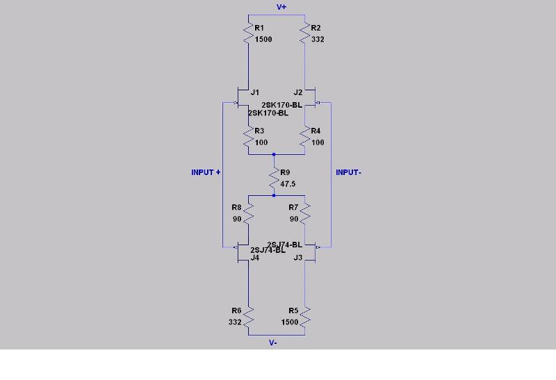

Re: Modified JC 80
Justcallmedad said:
… Just a global attempt to update the JC80 for fun, with today’s components.
Resistors values are changed to fit the Irf devices requirements and to reach a 20kHz bandwith in open loop.
The 2SK389 and 2SJ109 can be replaced by the 2SK170/2SJ74 of course, but also by other ones as suggested by JC, in this case R2/R3/R14/R15 must be adjusted. In my case the SK 389/SJ109 Idss value is 10 mA. Mosfets Idle Id is 50 mA. I changed the original input stage arrangement for this preferred one. It just a starting point, probably the MASTER will see some possible improvements. I didn’t build it, some measurements with real devices could lead to various modifications .
Gain 12dB.
Zout 50R per side.
The DC servo could be something like the one I post about the Blowtorch in this post
Why this bias scheme for the complementary differential input JFET stage, and not something like this, as e.g. used by Borbely?
RK

Neither input stage approach is completely optimum. The 3.3 ohm resistors are a little small, I would increase them to 4.7 ohms, just for safety. It keeps the input diode less prone to forward conduct. I usually prefer 10 ohms.
The other approach turns off the fets, and I doubt that you can get 1 ma each from the input devices with this approach.
I design with both configurations, depending on the quality of the design.
Hi, Justcallmedad,
About the schematic in post #1923, I've got some questions :
1. What is the function of R7 (220R to ground)?
2. Why you don't put degeneration (about 22-47R) on sources of J3-J4 (like usually done for self-biasing Jfets)?
Hi, Mr.Curl,
Still about this post #1923 schematic, if the input and output are only single-ended, it seems possible to make a preamp with just 1Pfet and 1Jfet in self-biasing mode, like Justcallmedad's.
What's the difference between this approach and use full complementary Jfets, 2Pfets+2Nfets (like Dennesen JC80)?

lumanauw said:
Hi, Justcallmedad,
Hi, Lumanauw,
1) R7 set the gain; it is « local » feedback or degeneration.
2) I use high Id on fet’s, higher source resistors lowers Id. (Idss from 12 to 16 mA / V range).
High Id lead to best measures as well as better sound, however John is right, 3,3R is on the low side for a power amplifier input, I normally use these values for mic preamps or phono inputs, more usually on low to medium inputs levels, -80 to -20dB.
