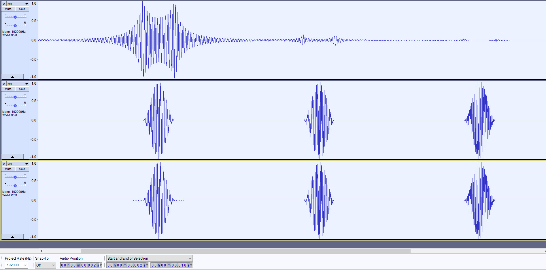

Further to the recent Cymbal posting, I made a 192Khz .wav file containing three frequencies, resp 22Khz, 25Khz and 30Khz, all contained in a 1Khz cosine envelope and separated by 5msec.
I then used a 20Khz Brick Wall FIR filter and subtracted the filtered from the unfiltered signal.
In the image below one can see resp. 1) the Brick Wall filtered signal, amplified by 40dB, 2) the original signal and 3) the difference between the two.
You can see that when having calculated the envelopes, that in that case Gibbs plus three 1Khz cosine signals would have been visible as a difference signal.
But apart from the addition of the Gibbs frequency, the envelopes around these 3 HF signals, do not take part in the sub 20Khz signal as you can see in the upper track.
In the 40dB amplified Brick Wall filtered signal, it's also obvious that the closer the HF signal is to the used Brick Wall frequency, the more violent the Gibbs amplitude.
This was all meant as a further explanation to my earlier posting, that when using just envelopes, a LF component within the Gibbs frequencies in the difference signal may be confusing, giving the impression that the LF part is affected by brick wall filtering, which is definitely not the case.
