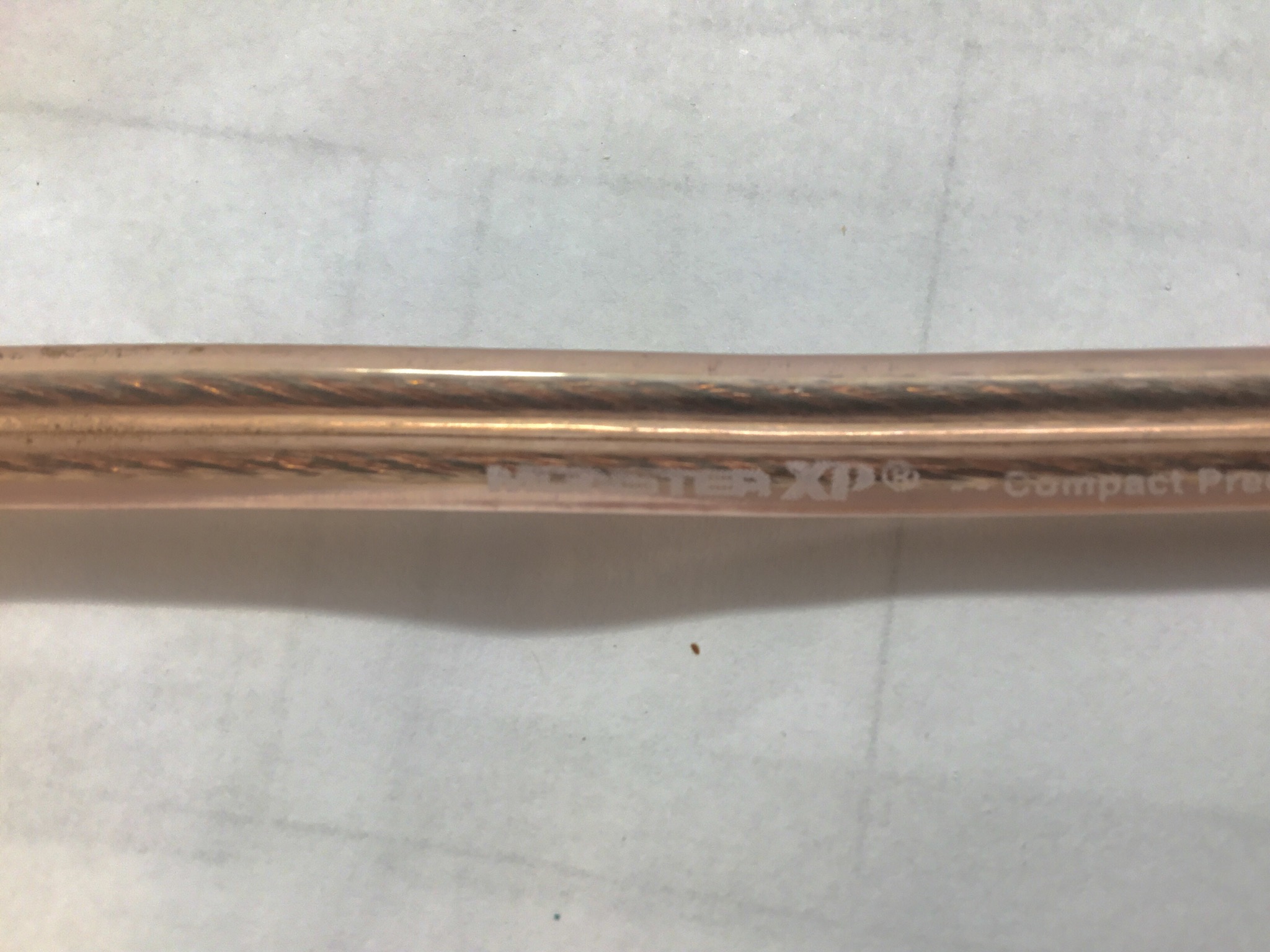

I can confirm that XP is 18 AWG (counting strands on this stuff is no picnic). The appearance was tuned to look "Monstrous". Be sure you are not confusing XP with OMC which is closer to 12 AWG but looks similar. Its pretty academic since Monster is pretty much out of the cable business (and be really cautious of the Monster from Walmart).
Yah, it says XP on it anyway......I’ll take your word for it but they sure did a good job making it monstrous!
Kindly weird the way it corroded like a candy cane.

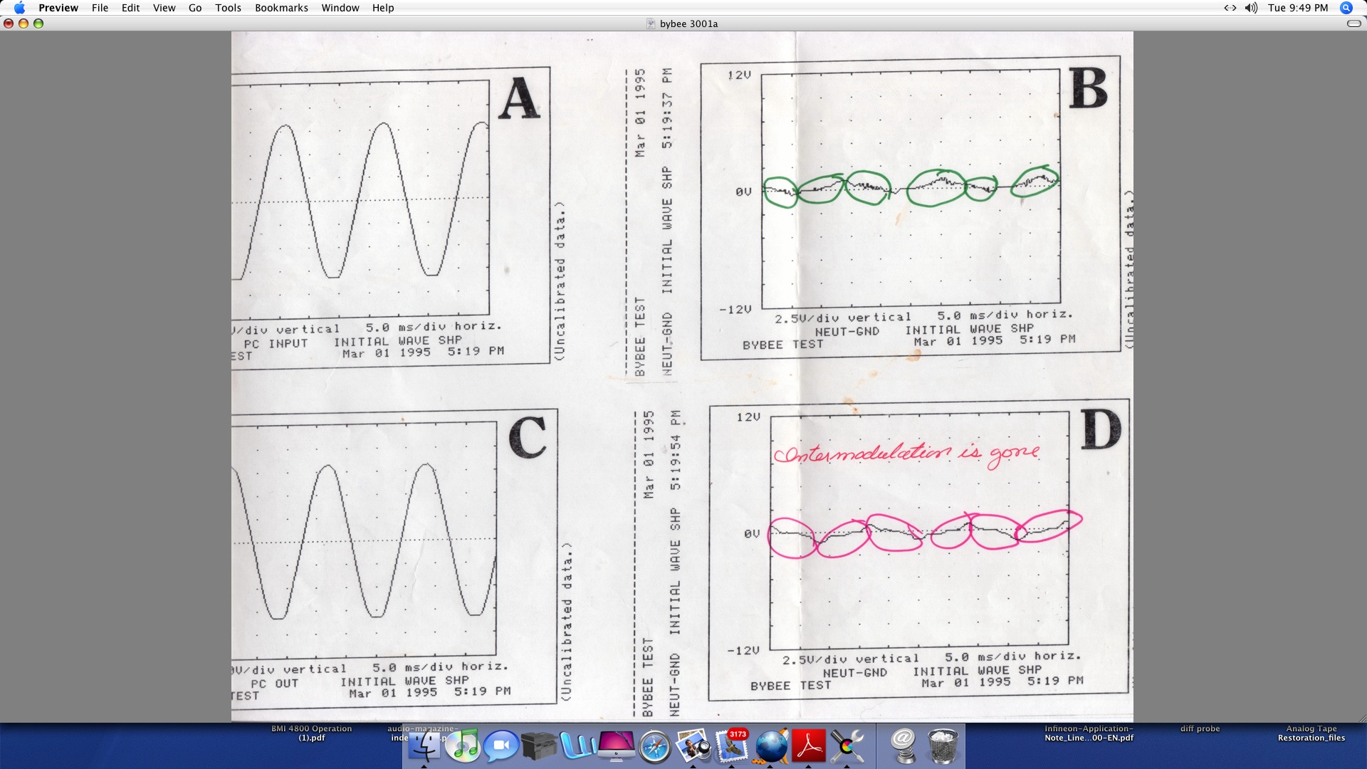

One example is that Bybee devices can and do affect sound, at least in some cases. From what I am told by people I trust, usually they make a good system sound slightly worse, but they can make a not so good system sound slightly better.
Anecdotes again. We have measurements of a bybee and not sure any mechanism besides a small DC resistance is found. So either the science that found the higgs boson is wrong or people are hearing things that are not there...
I didn't say stationary distortion. It may look like noise on an FFT, but sound like distortion. For example, quantizing noise sounds like distortion more than it sounds like noise, at least is does to me.
