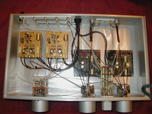

The Blowtorch preamp used Teflon for the insulating material, for the wires, backplate and spacers in the connectors, as well as the boards themselves. Even the Vendetta phono board EQ caps are Teflon, you know, $35 or so each.

Finally almost on topic, the blowtorch would have better than usual EMI resistance as it uses FETs. Bipolars really work quite well as AM demodulators at the base emitter junction.
Better than usual? I doubt it. If you have no RF ingress protection, chassis isolated connectors, and long wires you're doomed. A GSM phone will make this thing sing. It would probably fail nearly every IEC 61000-4 test as constructed.

Now, PMA is referring to the CTC Blowtorch because our thick aluminum case had potential flaws in picking up RFI. And he may be right, but we did not make any deliberate mistake.
The ALUMINUM case was to replace a steel case that might effect the electronics by inducing distortion.
The THICK aluminum case had several advantages: It shielded out lower frequencies, including hum frequencies to some extent because of its added thickness. It made a sturdy box that did not rattle or even resonate much, and it became a sturdy anchor for the military grade
Shallco switches that are pretty stiff, as well as the TKD pots that are nearly as stiff to turn. In the end, we 'hogged out' solid billets of aluminum, but we tried aluminum welding first. We made our first prototype this way, but we decided that the chance for external marring was too much for this approach. Our customers, besides our own personal friends were often very touchy as to what an outside surface looks like, as much as how it performs, and I found this to be so, even beyond what we first expected.
We did not RFI test the box, so PMA might have a point, but added internal shielding would have changed the sound quality so we did not use it, because we thought we have kept the box RFI sealed adequately, at least for lower frequency RFI, so we just separated our silver wires from each other, (that is why they are not neatly bundled together) to keep the Xtalk at a minimum.
All in all, we never had any complaints from our customers or ourselves, only PMA. Go figure! '-)

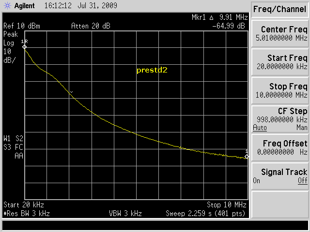

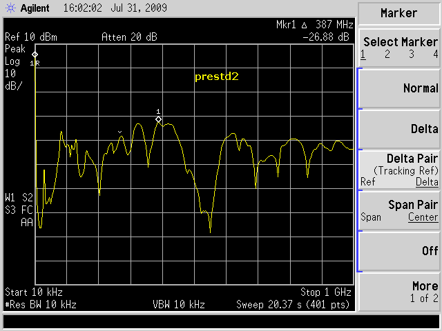

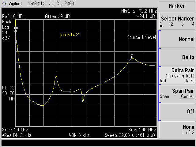

I have never said that thick aluminium case had potential flaws in picking up RFI. The case itself is OK and is very effective as a shielding. But, the wire input through insulated RCA connectors is a big, big problem (please see the CTC box and RCA connectors on the left and also next to XLRs). This is an input gate for RFI arriving in along the signal wires. Measurements to be done to check.
I am attaching measurements of a similar box with insulated RCA connectors and link preamp inside. Measured with Agilent RF spectral analyzer. One can see that up to some 20MHz HF attenuation is good. But then it starts to have wild behavior, as seen from measurements up to 100MHz and 1GHz. Input on-board RC filter does not help, the HF signal, once allowed to get in the box, easily bypasses audio circuits and appears at the output attenuated not very effectively.
In case that you have different results, please show them. Your customers would never know this and would have no chance to make a comparison with proper solution. No wonder they do not complain.

Maybe you are right, PMA, but we were not preparing for an extremely high RFI environment, but for playing music in a home. We have had no personal problems and no complaints from the customers. We would probably still do the same thing if we had to do it again, but IF we were subject to mandatory RFI testing like you have in Europe, perhaps we would add some RFI suppression, as we have had to do with other preamps. This is usually found by the RFI testing facility in Europe, and they usually advise how to change the design so that the preamp can pass. We HATE to compromise our products this way, but sometimes it is necessary to do so.
