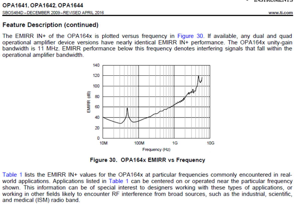

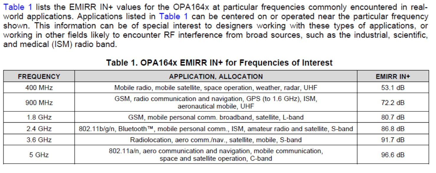

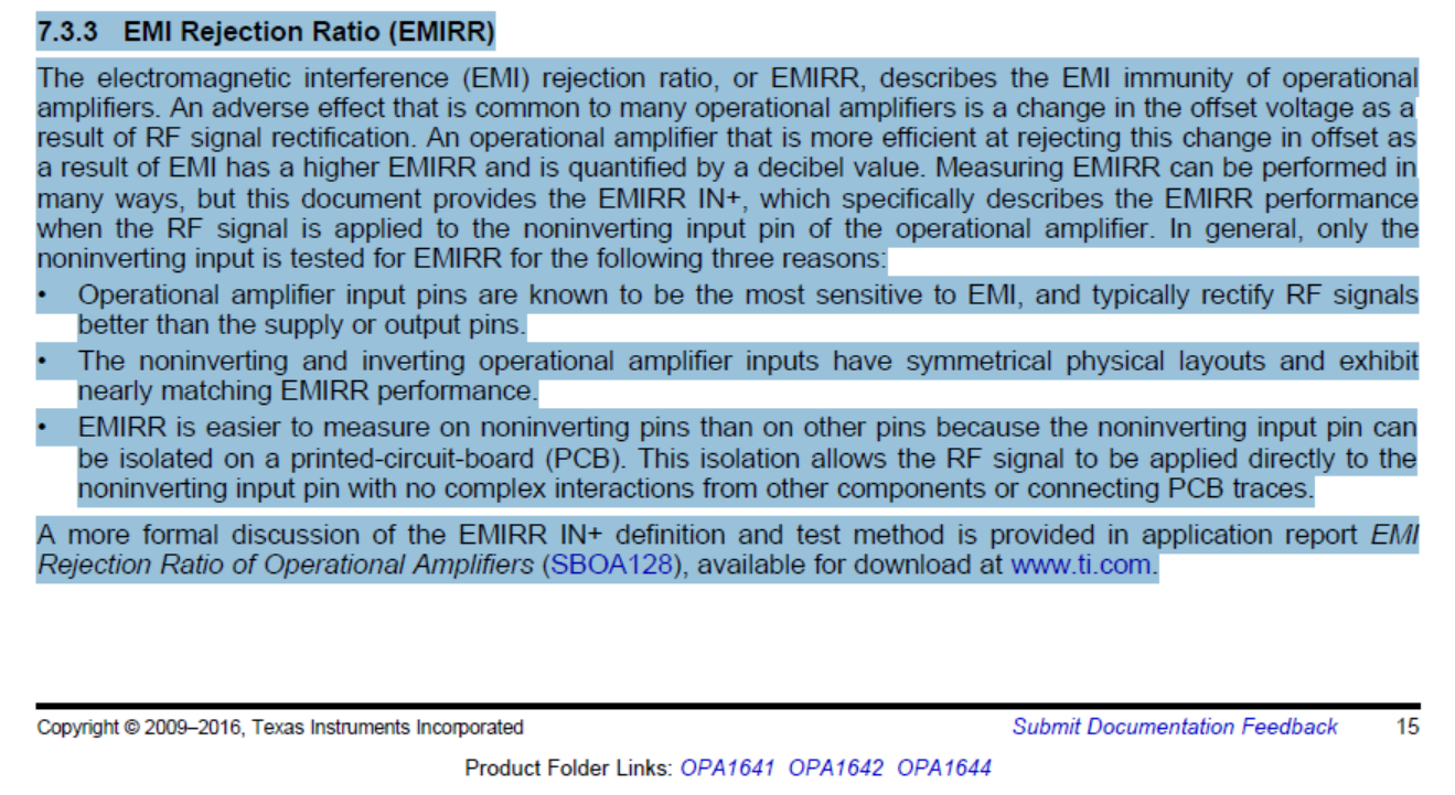

Hmm, emirr:
"In general, only the noninverting input is tested for EMIRR for the following three reasons:
• Operational amplifier input pins are known to be the most sensitive to EMI, and typically rectify RF signals better than the supply or output pins.
• The noninverting and inverting operational amplifier inputs have symmetrical physical layouts and exhibit nearly matching EMIRR performance.
• EMIRR is easier to measure on noninverting pins than on other pins because the noninverting input pin can be isolated on a printed-circuit-board (PCB). This isolation allows the RF signal to be applied directly to the noninverting input pin with no complex interactions from other components or connecting PCB traces."
From:
OPA1642 Sound-Plus High-Performance, JFET-Input Audio OpAmps | TI.com

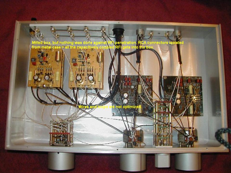

Yes and please do not forget that you need a perfect milled thick wall Al box + all the wires getting in through insulated connectors without any filtering to bring the interference el. field inside to enable capacitive coupling into the bare Ag wire nests, this makes just the true highend sound essence.

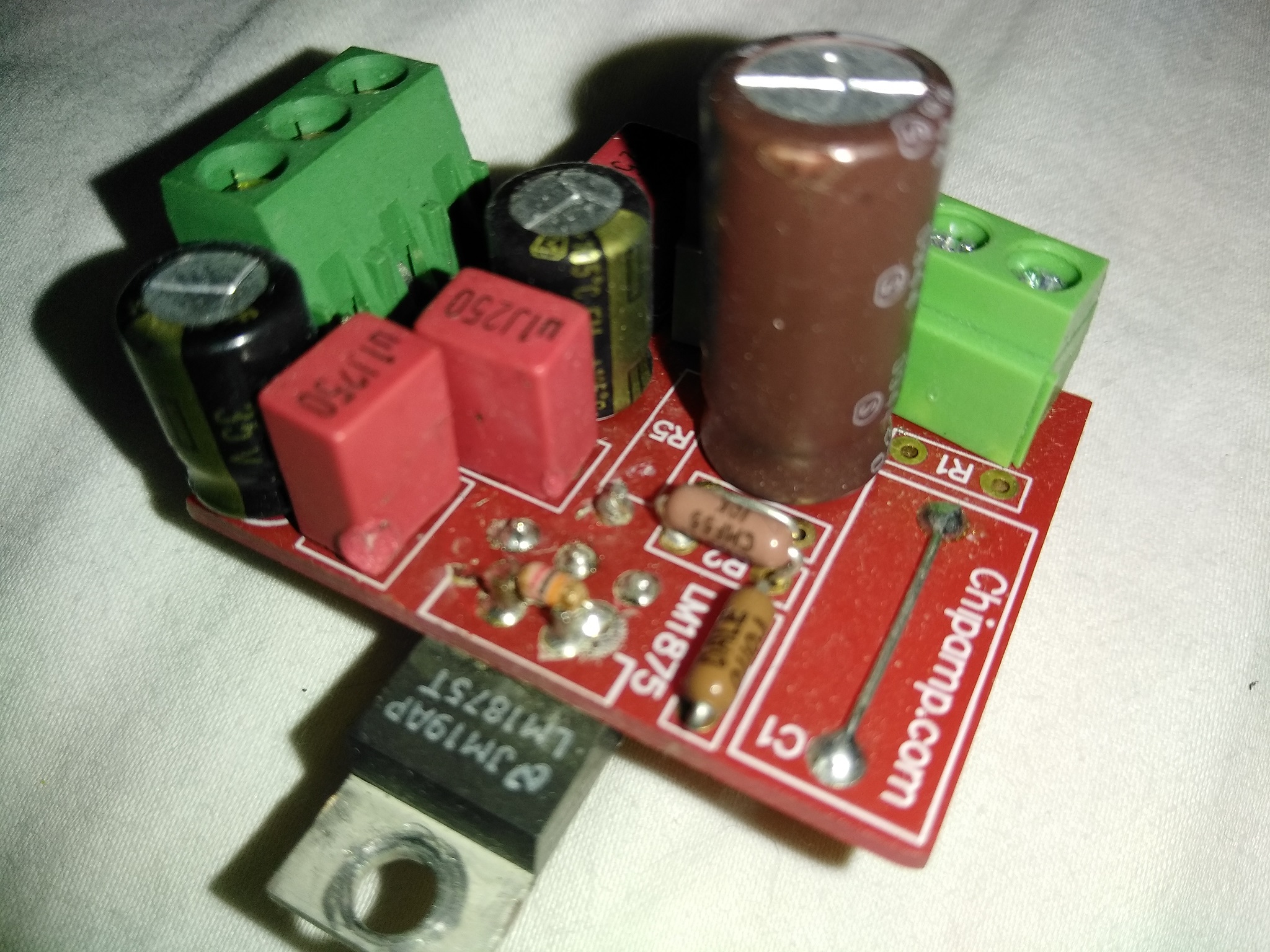

He should have used an LM1875!!!
Features:
World's smallest number of parts - 9 parts per channel( excluding attenuators )
World's shortest signal pass length - 32 m/m ( including the length of parts )
World's shortest NFB loop length - 9 m/m ( including the length of the resistor )
World's smallest filter/condenser - 1000µF, (50W version - 2200µF)
Dual mono construction with each channel in a separate chassis.
Rigid and compact aluminum chassis construction to release vibrations smoothly.
Separate 12-position attenuators for each channel.
Can be up-graded into a pair of complete mono amplifiers by adding another Model 4700 Power Humpty.

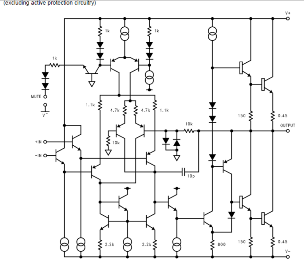

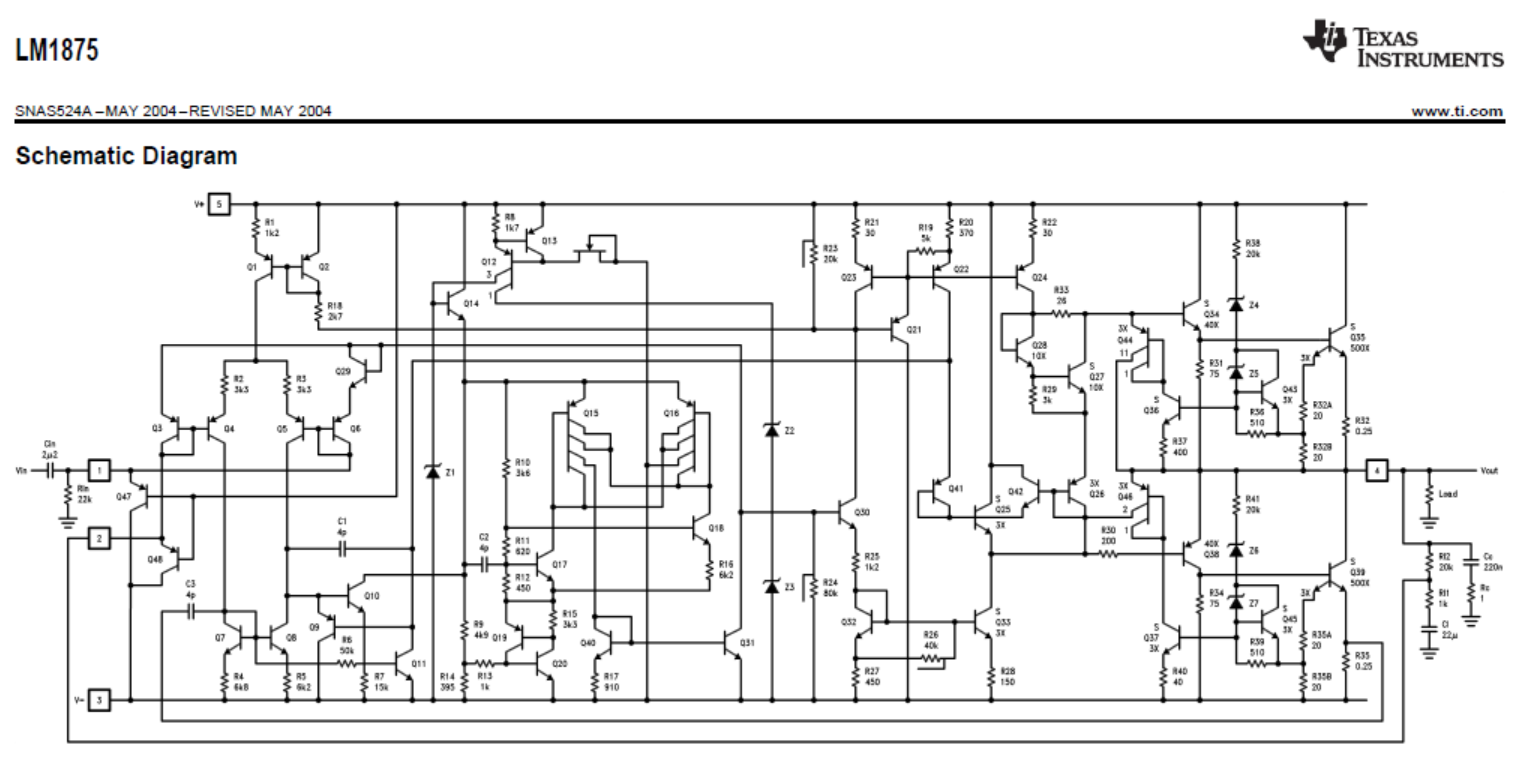

4706
"9 parts per channel", I guess they forgot about:
and more like:

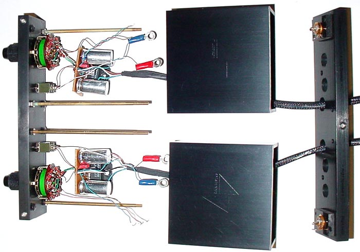

Now, PMA is referring to the CTC Blowtorch because our thick aluminum case had potential flaws in picking up RFI. And he may be right, but we did not make any deliberate mistake.
The ALUMINUM case was to replace a steel case that might effect the electronics by inducing distortion.
The THICK aluminum case had several advantages: It shielded out lower frequencies, including hum frequencies to some extent because of its added thickness. It made a sturdy box that did not rattle or even resonate much, and it became a sturdy anchor for the military grade
Shallco switches that are pretty stiff, as well as the TKD pots that are nearly as stiff to turn. In the end, we 'hogged out' solid billets of aluminum, but we tried aluminum welding first. We made our first prototype this way, but we decided that the chance for external marring was too much for this approach. Our customers, besides our own personal friends were often very touchy as to what an outside surface looks like, as much as how it performs, and I found this to be so, even beyond what we first expected.
We did not RFI test the box, so PMA might have a point, but added internal shielding would have changed the sound quality so we did not use it, because we thought we have kept the box RFI sealed adequately, at least for lower frequency RFI, so we just separated our silver wires from each other, (that is why they are not neatly bundled together) to keep the Xtalk at a minimum.
All in all, we never had any complaints from our customers or ourselves, only PMA. Go figure! '-)
